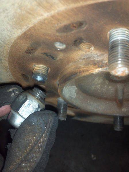

    So I screwed up the threads on one of my rear wheel lug nuts. Is this safe to drive (going to get it fixed ASAP) if all of the other lug nuts are still 100%? How do I remove the old stud? or is this something better left to a mechanic?
    truck is a '12 SR5 4.0L 6 lug
    *the stripped lug nut is on the stud but it's only on there a few turns and pretty loose

    You'll be fine. Make sure the others are tight and don't try to set any land speed records until it's repaired.

    If you don't tow or haul anything, it will be safe to drive it in for repair with 5 of the 6 properly tightened.

    If you're interested, on my first gen (probably the same for you) replacement is really really easy.
    Just pull the drum off, pound out the old stud and press the new one in with a lug nut and a bunch of washers.

    Napa Didnt have the NES tool. I picked up a new stud and lug nut from toyota and will swap them out myself. After a few youtube videos, it shouldnt be a problem

    Here's my experience. I was driving around with 4 lugnuts on DR and 5 on the PR. All fixed now.
    Protip, if the studs don't go in easy enough, but them in the freezer for a few hours. I did this but don't think I really needed to, they went in SUPER EASY.
