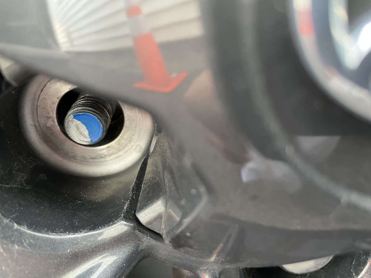

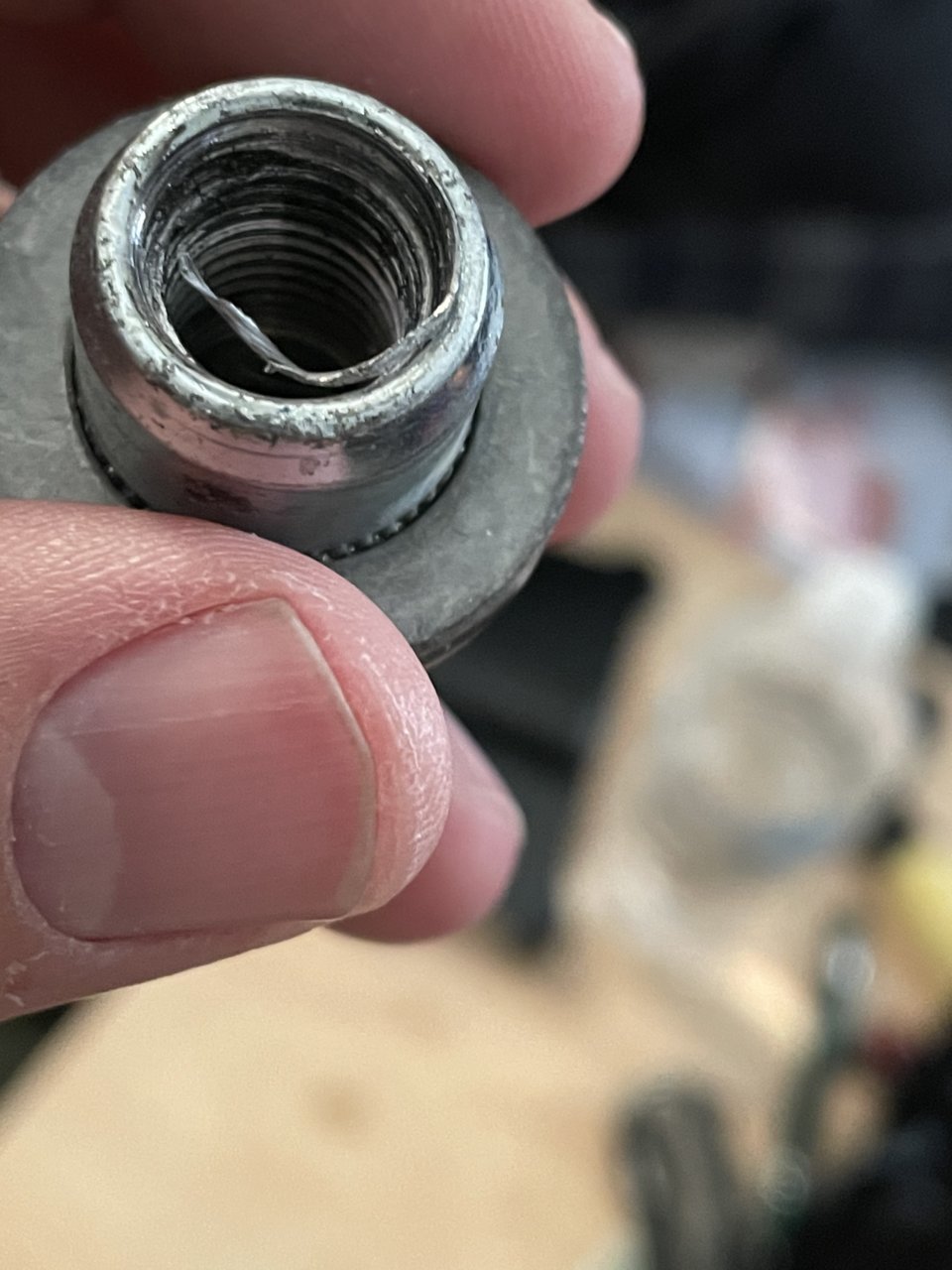

    I have changed out sets of wheels on track cars with impacts, definitely have to get the lug nut started before you use an impact. If I were a betting man, this was the first lug nut that the tech put on the wheel. Looks like the wheel was hung and wasn't flush with the hub before the tech zipped it on with an air tool.

    It is possible that the tech that found it, found it. Someone has to and with this type of mistake, it is easy to blame the guy that found it. It is also possible that the guy that did it had no idea. I have seen people run a lug nut on and even torque it without knowing their mistake. It is a very cheap fix and not worth getting your customer mad or inconveniencing them. You want to make a customer happy? Say "someone cross threaded your lug nut, not sure who it was, but I fixed it for you, no charge." You will probably have a customer for life.

    I actually stripped some of my own lugs when I first got my truck. I had the tire shop mount and balance my tires but not put them on my truck (lift wasn't on yet), so I took the lug nuts home, got the lift on, started the lugs by hand, couple turns like I always do then hit them with the impact to snug them all up. Well, the tire shop gave me 1.25 pitch nuts instead of the 1.5 pitch I needed and 1.25 will thread on a fair amount. I replaced the couple lugs I stripped in ~10 minutes, took the nuts back to the tire shop. The guy rolled his eyes, gave me what I needed and asked if I needed lugs replaced. It's such a simple thing on these trucks to replace them.
