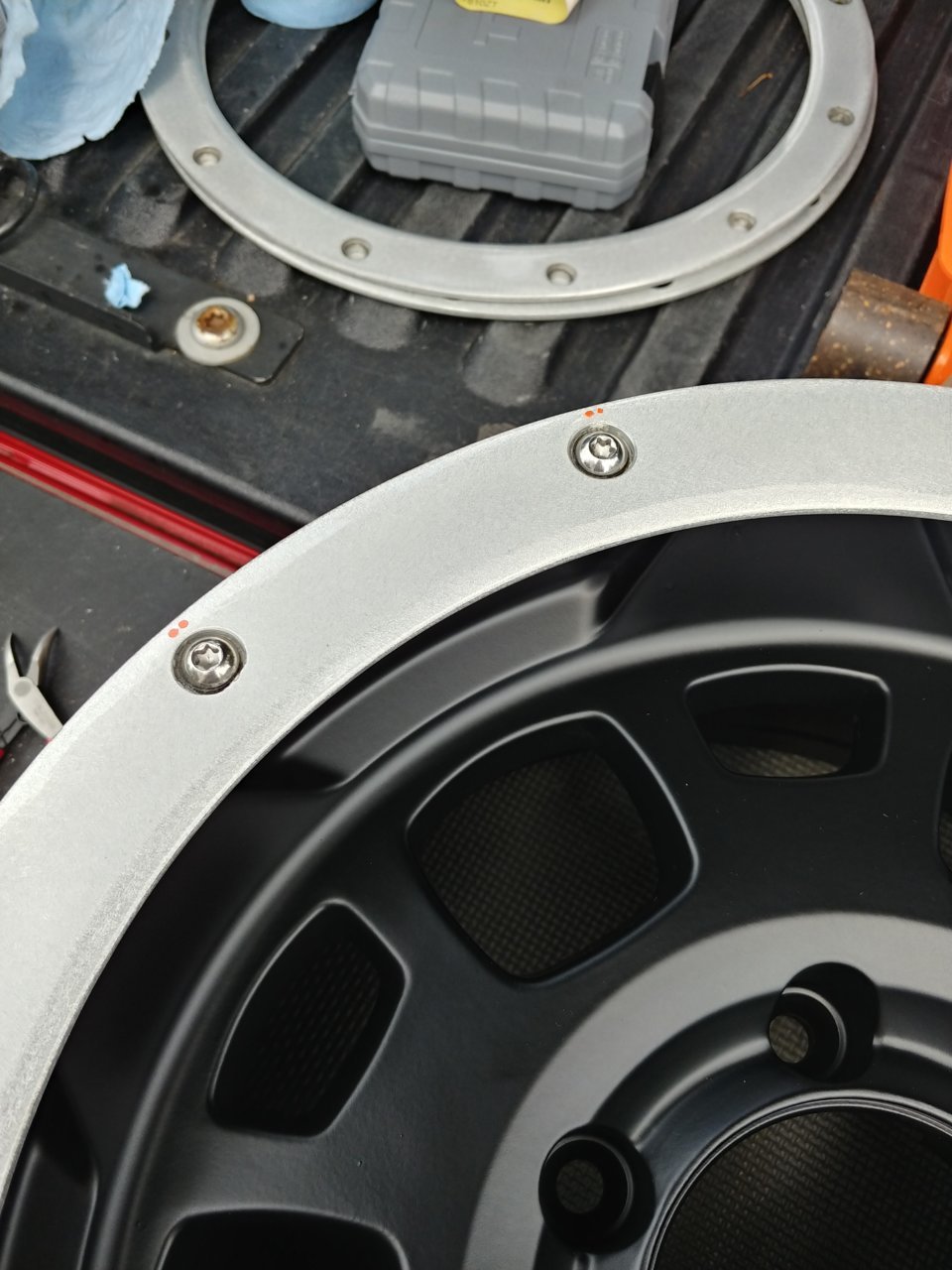

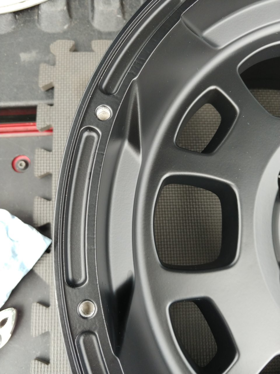

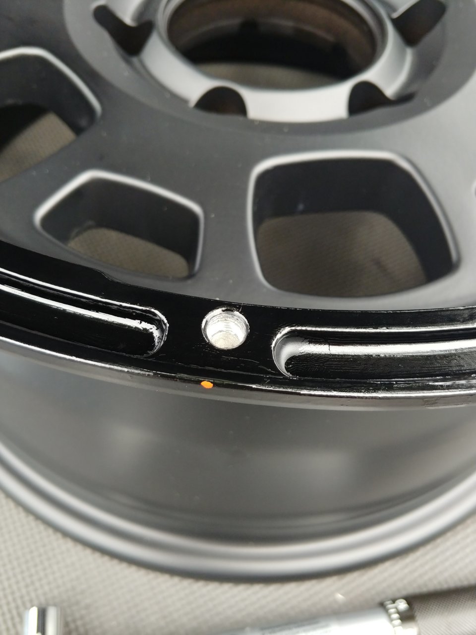

    Cross posting from the TX Baja thread for more visibility. Any ideas would be appreciated. Im supposed to get these mounted tomorrow morning..
    I'm in the final stages of getting my wheels back together after powder coating.
    Thanks to Maine's unhealthy obsession with using as much calcium chloride and road salt as possible, the surface between the rings and wheels was pretty rough. As are all the M8 threaded bolt holes. I'm sure you can see where this is going...
    So far I've stripped out 3 of those bolts, hardly past finger tight. Several more are close and will definitely strip out before they reach a decent torque
    Any thoughts on how I repair this cluster? I'm wondering if I can put some rtv in the hole, then thread the bolt in, let it set and snug it up. Not sure if I can helicoil these due to how close they are to the bead. Not even sure if they make helicoils in M8x1.0

    Yes I ran a bottoming tap through all 48 holes (by hand) before beginning reassembly. I think it actually made things worse, to be honest. The tap certainly disturbed whatever soft corroded metal was there
    I only have two that are completely striped out. Seven others feel very soft and I did not fully torque them, but technically those 7 are holding themselves. Plan to helicoil those two asap and monitor the other seven (at this point I dont want to disturb anything more than I have to).
    Everyone keeps mentioning filling with epoxy / JB weld. I like that idea, only thing Im hesitant about is making sure the new hole is centered and straight. Oversizing the existing hole for a short 8mm thread insert will be easier I think using the existing as a guide

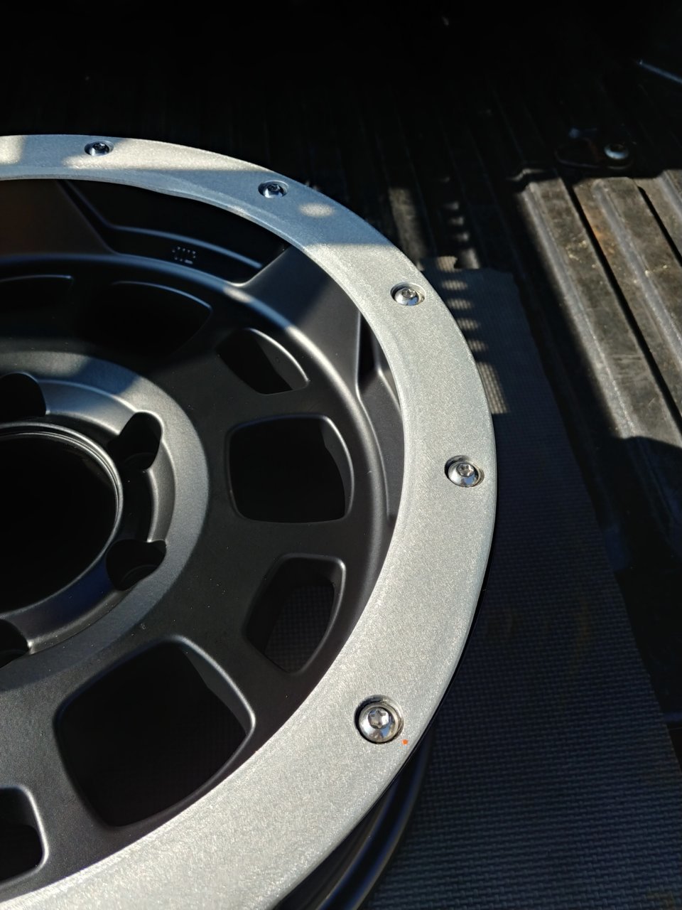

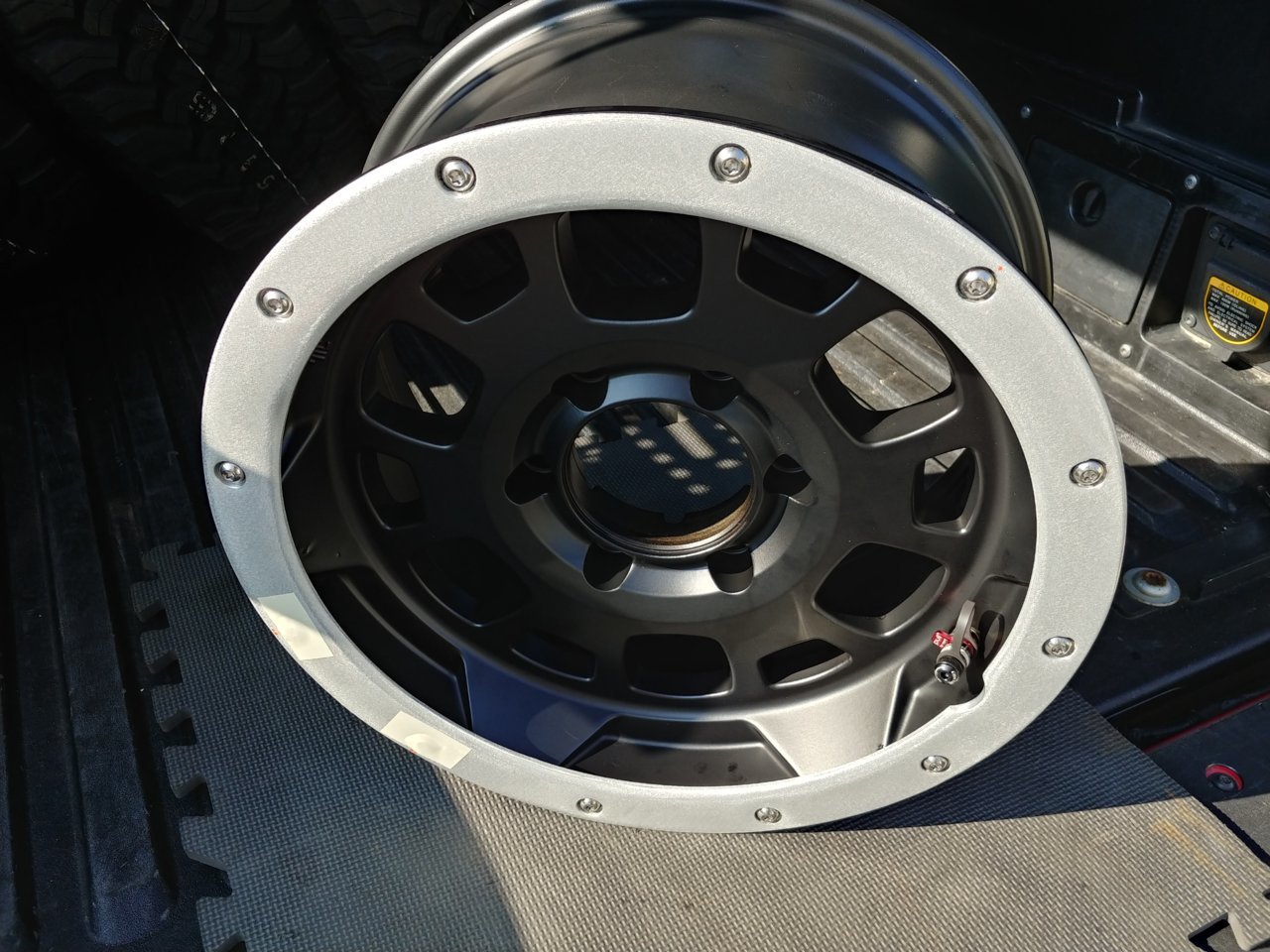

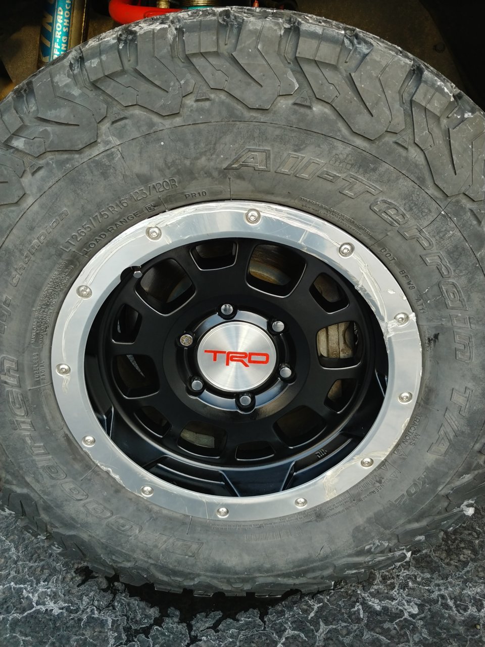

    Ended up going with some appliance tape as a temporary measure :D
    I think the brushed finish turned out pretty good all things considered. I know you and I had talked about that when you stopped by my neck of the woods a few weeks ago
