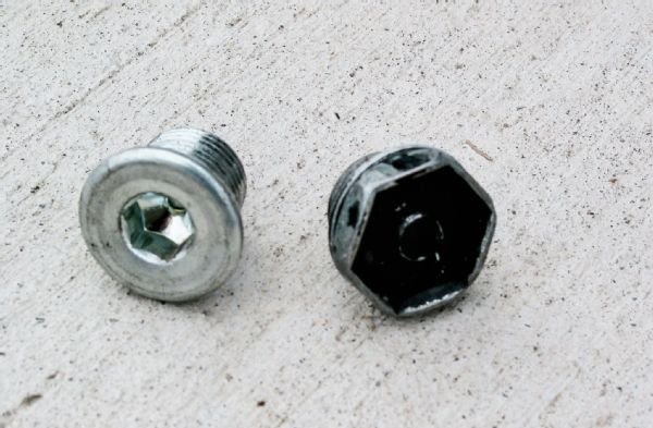

    DaveInDenver
    DaveInDenver Not Actually in Denver
    May 18, 2013
    #104390
    3,604
    David
    Grand Junction
    2008 Super White TRDOR AC 6MT
    Unexceptional
    I hate the stock hex bolts (like on the right). They round off, they get boogered on rocks. I've had a corner get caught on a rock and turn the plug loose enough to leak.
    So I replace them with the Allen key type (on the left). The actual application for the part is, I think, a Rav4 or something.
    If you want to convert them all to use Allen keys the Toyota part numbers.
    Drain (magnetic) plug: 90341‑18021
    Fill (non-magnetic) plug: 90341-18016
    O-ring for aluminum (transfer case, manual transmissions): 90430-18008 (O-ring is a Toyotaism, it's the flat metal washer)
    Crush gasket for steel (diffs): 12157-10010
    The only outlier is the front diff drain (the one in question in this thread), which is that special monster bolt and gasket.
    sioux likes this.
