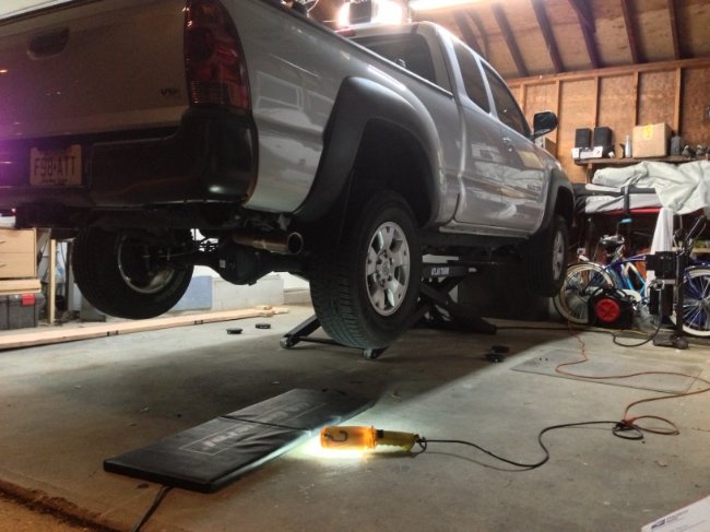

    Get a lift now since it's gonna take you 20 oil changes to break even :D

    What kind of lift is that?

    A basic midrise scissor lift, makes life a lot more civilized in the garage.
