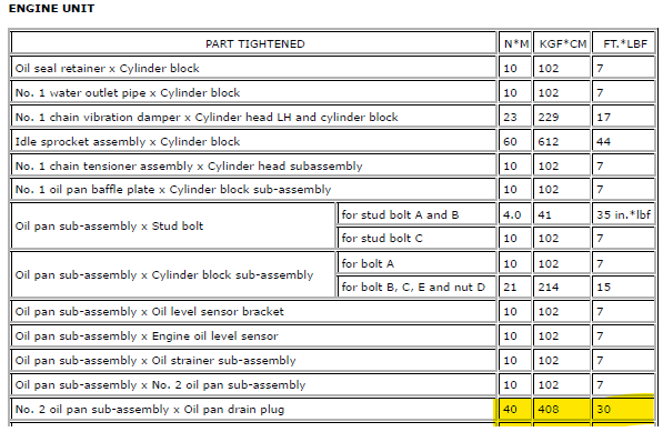

    Palm Desert, Ca
    2023 TRD Off Road
    30 ft lbs is insane IMO. Who uses a torque wrench on an oil pan drain plug? Gotta be a bunch of pans out there used, I'd do that first.

    Torque wrenches have their place no doubt but, for any fluid drain bolt, I use my best judgement, and not a torque wrench. You can tell when it is too loose, or too tight and it's going to strip. With oil or anything that adds lubrication on the treads of any bolt, the torque numbers will be off. That is probably where the mistake was made. Synthetic oil on threads, made it way easier to get to tight, and the torque wrench wanted you to keep going to get to it's set parameter. Sorry this happened to you, lesson learned. Good luck on the fix, keep us posted when you get it done. It will help others down the road, that may do the same. Ski

    :anonymous:
    Me.
    If a little torque is good, a lot of torque is better. The torque wrench keeps me from being dumb. Dealing with plenty of small fasteners into aluminum threads on my bikes, I am happy to have not stripped any using a torque wrench.
    Agreed though, 30ft-lb seems wrong. I think the number is under 20 for the drain pan.
    I do not like that number. 20 is plenty.

    Never have and never will torque an oil pan drain bolt to 30.
    Toyota, however, seems confident in their numbers. If memory serves me correctly, that's right up their with their recommendation on the 4Runner and Tundra.
    Just not gonna do it.
    Polaris says I should torque the conical lugs on my RZR's alloy wheels to 120.
    Just because an engineer says so, doesn't make it gospel. (unless, of course, you ask and engineer)

    I've seen plenty of errors that make it through. I have to feel this is one of them.
    There are sniff tests for sure.
