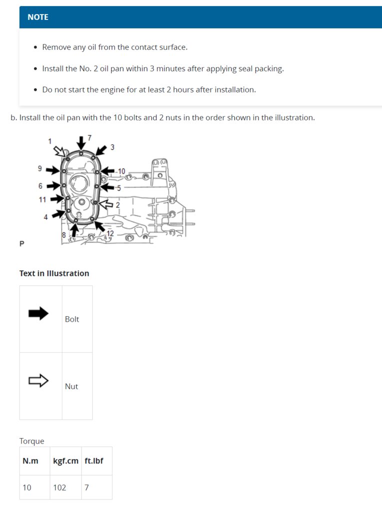

    Yeah I'm going to my local dealer on lunch break and ordering a new one. Not big on the ebay pans (who knows if they have dents or similarly stripped threads) and lkq has nothing. I was moreso wondering if a helicoil was a good option for this application, and thanks to the guys on here I'm not going that route.
    Didn't even think about wet vs dry torque.
    Do any of you know if the oil pan just requires Toyota FIPG rtv material, or do you use other gasket material in addition? Haven't seen a good answer on that.

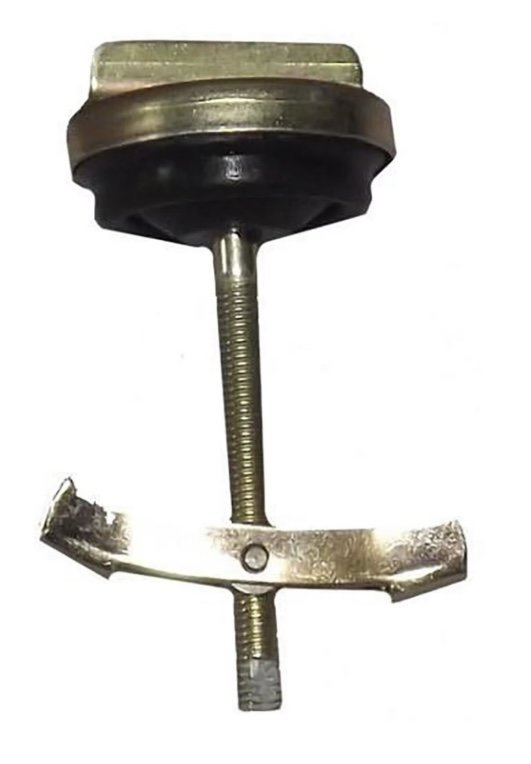

    A WM dbag rifled a drain plug in my ‘92 Safari. F. I bought this IMG_1526.jpg and it worked actually better than the oe. Yes it hangs there and gets covered in draining oil. Don’t care. $10.00

    If it works, it works. ;)
    No tools required fix.
    It's one of those fixes that "isn't right". But it works.

    It's a 2 piece pan. So it shouldn't be too hard to change.
    You just need the lower pan.
    Toyota just uses RTV. Nothing else. No other gasket.

    Reserected from the dead.
    I used the permatex black when I did my Tundra. Zero leaks 2 years later.
    Just use common sense when tightening the pan bolts. You are going to be amazed at how easy they are to remove.

    The bolts pretty much just hold it there. The RTV seals it and "glues it on".
