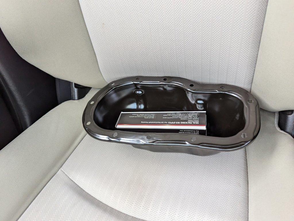

    $214, one day shipping for the pan and rtv to my dealer. Didn't come with a plug for anybody curious

    Make sure the engine mating surface, and the new pan are completely clean, dry, oil free, and no left over sealant from the original pan, prior to sealing with FIPG, and installing the new pan. Look up the bolt tightening procedure for the pan, or at least do a crossing pattern. Ski

    Aftermarket pans typically come with a plug. OE doesn't I guess. Too bad there's no aftermarket pan yet for the 3.5L (the 4.0L has 5-6 vendors).

    @abou824 wait until the FIPG fully cures before filling up the oil and starting the engine.

    There is an aftermarket pan from Dorman for the 3.5
    Thanks! Will do. Gonna be doing it on Thursday so I'll update the thread then.

    Don’t feel bad. Mine stripped out after 18 oil changes. Lower pan replacement isn’t difficult.

    Were you torquing to 30ft lb?

    Just snug, may have went over a few times
