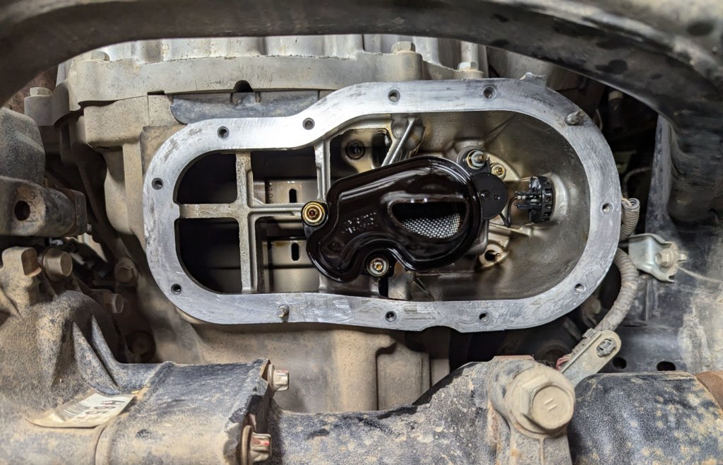

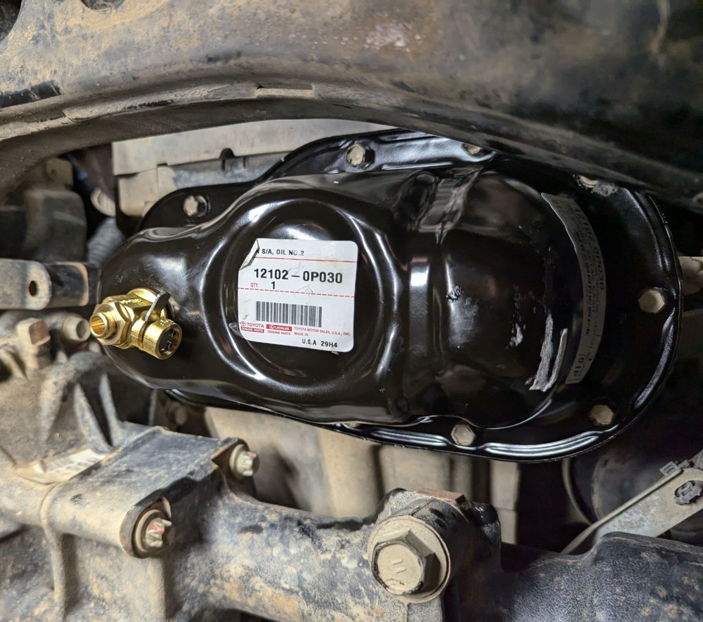

    The Toyota FIPG directions say you can drive it after 30-60 minutes, but I'm letting that cure till I'm done with work tomorrow. Then I'll fill it and take it around the neighborhood and check for leaks. Not a hard job at all. 80inlbs feels like nothing, the bolts came out shockingly easy too. Guess Toyota didn't want to strip the upper assembly.

    Was there much oil in the pan when you dropped the original pan?
    When I did mine, I was surprised.
    At that point I gave up doing oil changes on a hot engine. I figured what drained out of the cold engine was good enough. No burns either was a bonus as well.

    Yeah there was a decent amount in there still, maybe half a pint. The oil pickup sits down in that little area below the plug so it makes sense, but you'd think Toyota would want all the oil to drain out.
    I never change my oil hot. Did it once on my other car, never again. 0w20 is so watery that it doesn't matter anyways.
