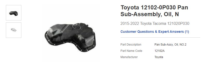

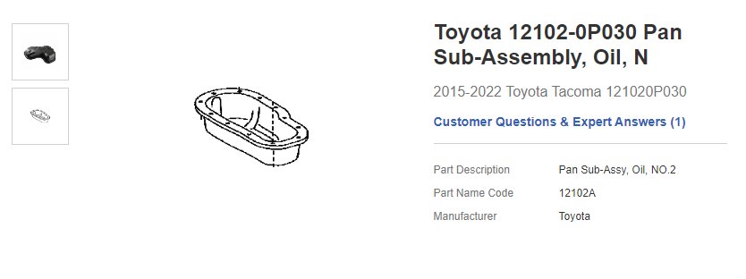

  11. Oct 17, 2024 at 9:10 AM
    #131
    BobsTaco91
    BobsTaco91 Active Member
    Oct 8, 2024
    #458438
    25
    2017 TRD Off Road
    Hey TW, just want to confirm. That lower oil pan part number is 12102-0P030? Looking to replace it in the future, maybe even next oil change. When I hand tighten the bolt, it goes about halfway and then it needs a bit of force before it keeps screwing on. Still goes on tight, no leaks but definitely scared that threads may be going. Anyways, i'm a bit skeptical on order because Toyota shows two different pan shapes. This happen to anyone else? Or am I just blind and looking at these wrong LOL.Toyota Oil Pan 1.png Toyota Oil Pan 2.png
