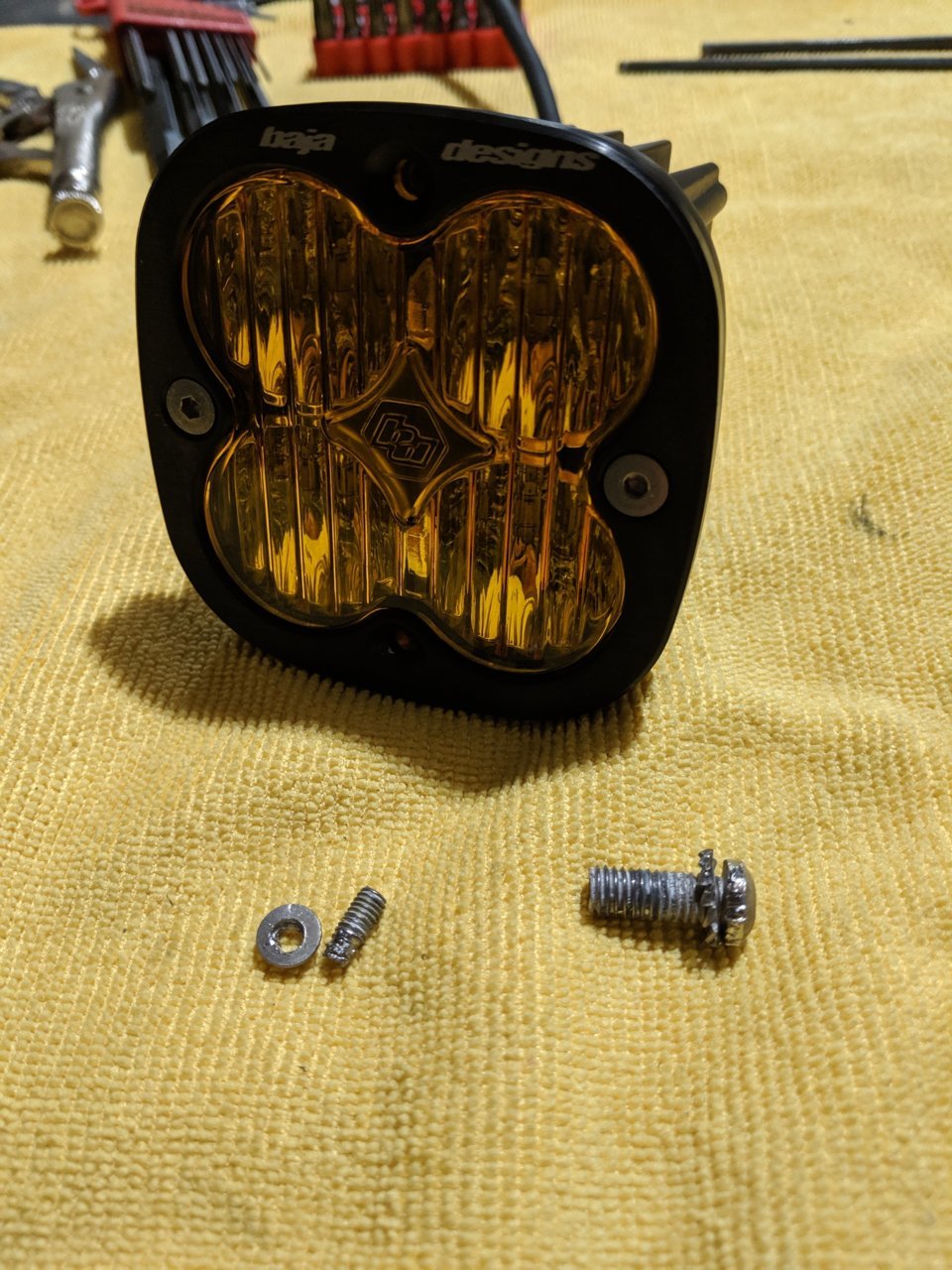

    I just swapped my Squadron Sport fogs for a set of SAE fogs today and I destroyed several of the stainless screws it the process.
    I have the Tacoma specific Sport kit and I bought the universal SAE fog kit to save a little cash.
    When I was removing the mount brackets, the combination of dissimilar metal corrosion and the included yellow loc-tite helped me strip 2 screws. I was able to remove them with vise-grips.
    I also stripped 2 screws on one of the bezels. Had to drill the heads off and removed the the shanks with my trusty vise-grips.
    I installed all new stainless hardware with anti-seize.
    Your products are the best but please, at least switch to blue loc-tite on the bezel screws since they are small diameter.
