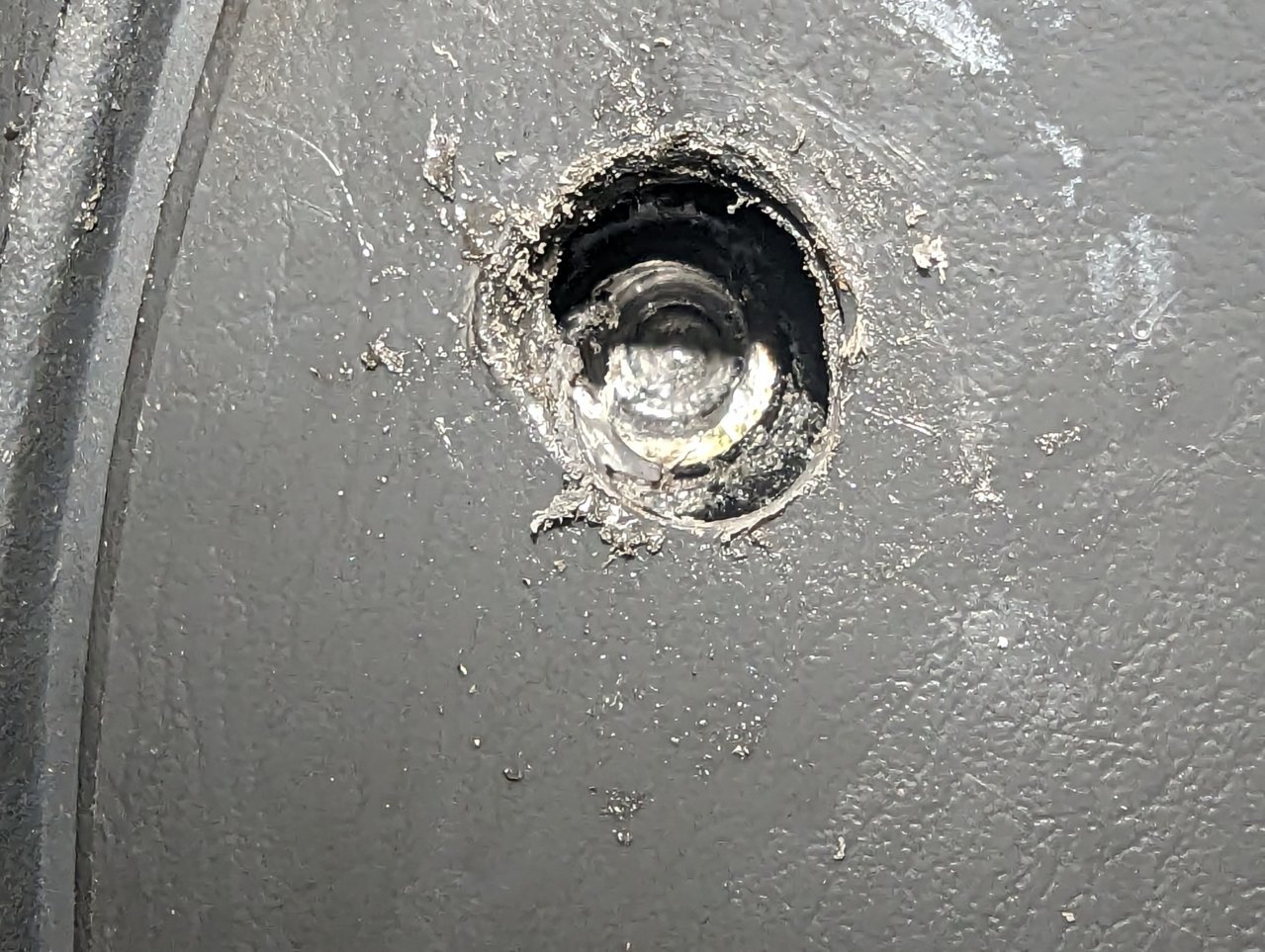

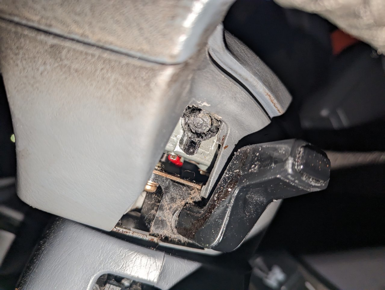

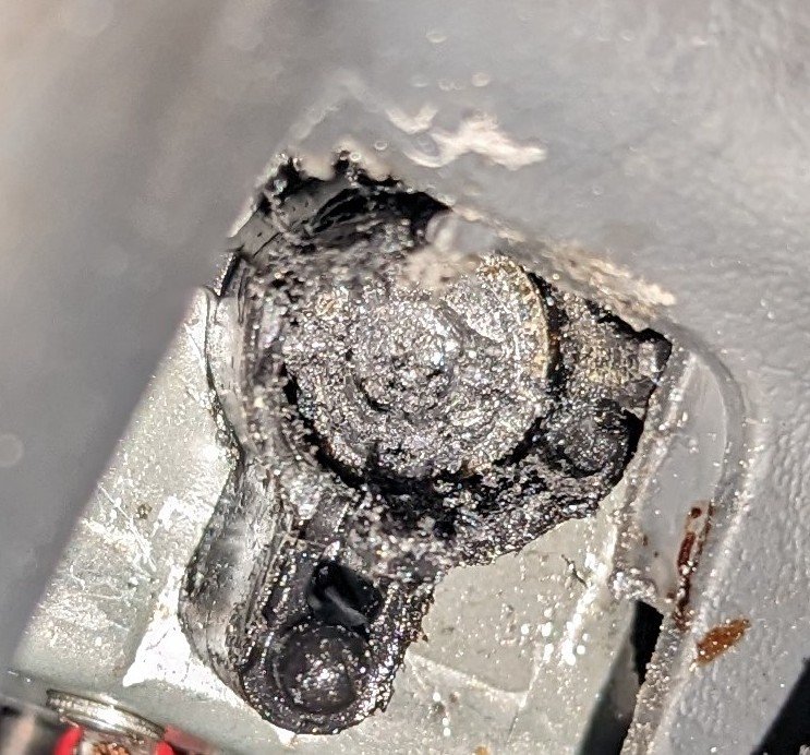

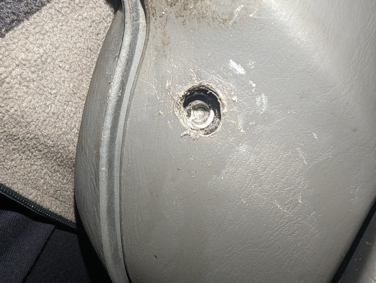

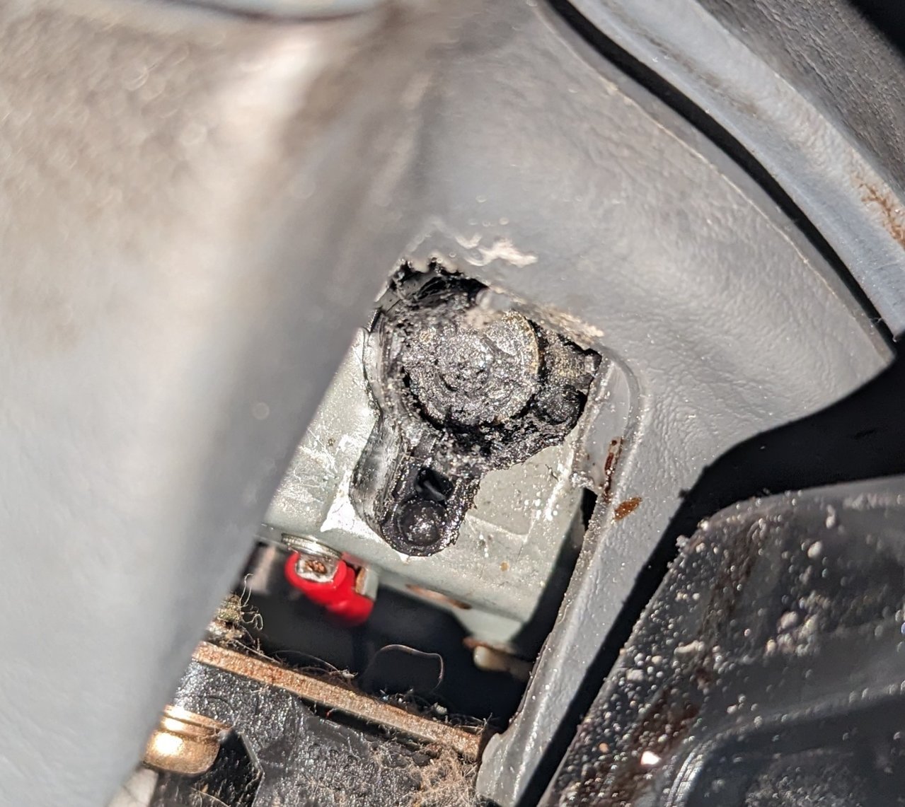

    I was planning on doing the steering wheel upgrade, but accidentally stripped the torx screws holding the airbag in place. That loctite is a real PITA. Anyway, first thing I do is PB blast the bolts (and continues to do so every step of the way), then try is a rubber band around the torx head, no luck. Second thing I tried was using a carving Dremel bit (125) to carve new grooves to fit a flathead in there, but it didn't eNextven leave a dent. Third was the screw extractor kit. I start small, and work my way up to the largest one I have, but they all refuse to bite. Next, I tried to epoxy a hex wrench in there. I let it set a day, but the wrench just broke out without moving the bolt at all. Finally, I tried drilling out the bolts completely but after several HOURS of drilling too many dead batteries later, I've barley made it a few millimeters. I'm at my wits end with this, and have no idea how to get these damn bolts out. Anyway, here's what they look like now. Any suggestions on what to try next would be greatly appreciated.
    Edit: sorry about the gallery of the same shot there, I'm posting from my phone and there was no notification that the image uploaded correctly. Whoops.

    Good new sharp cobalt bits and drill the head till it falls off is about the only thing I can think of, than once it’s off you can extract the rest of the bolt.

    Yeah when you bust Loctited anything delicate loose.....touch the head of that fastener/nut with the tip of a 75w soldering iron..
    and count to twenty...turns it to butter....old RC trick....
    I would go buy u a multi pack of 1/8" high strength steel drill bits...
    and put em in a dremel....
    using a right angle adapter or wand on that dremel could make it little easier...
    use some cutting oil...or wax.......crayola...

    Looks and sounds like a nightmare. Drilling is likely the only option. $$$ drill bits.
    Welding a nut on is a possibility. That would be dangerous welding on an air bag though.

    Keep drilling. Got it. I'll head to Home Depot first thing in the morning and grab some tougher bits. Maybe some more cutting oil too. Hopefully it won't take too much longer.

    I never seem to learn the lesson "right tool for the right job". The cobalt bits made quick work of those bolts, took me 5 minutes tops to drill them out, I should have gotten those from the start instead of wasting 2 days. Thanks for the replies!
