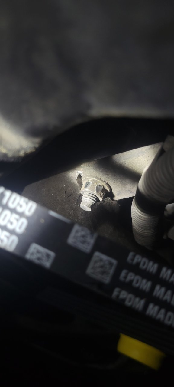

    Today I was in the process of replacing my radiator and doing a thermostat replacement.
    So two things happened:
    1. The plastic fastners that hold the grill where brittle and broke. Where can i order some and what are they actually called?

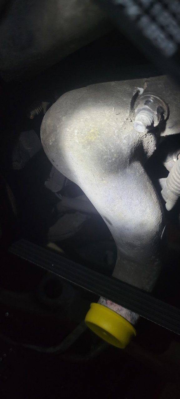

    2. I found that one of the thermostat housing nuts was stripped by whomever replaced the last thermostat. So tomorrow I'm going to take it off. But my dilemma is where can I get another 6 point nut?
    Are these nuts special order nuts? Or can I go to my local auto parts store and replace it?
    Thanks in advance.

    Auto parts or hardware store

    Any hardware store; it'll be metric.
    I hate when people strip nuts that could easily be prevented; I specifically bought (and suggest to others) a nice swivel and 6 point socket that grabs the walls of a nut or bolt to prevent from corners getting rounded.

    Any good hardware store will have a flange nut that size. Get a grade 8 or better and use a 6 point socket instead of a 12 point to save yourself some grief.

    The nut is either 6x1.0 or 8x1.25

    when working on these vehicles a box of M6x1.0 , M8x1.25 ,M10x1.25 and M12x1.25 JIS** nuts if you can find them
    will cover most of your dropped or rounded hardware.
    **JIS Japanese Industry Standard

    Thank you guys.
    Bought the nuts at my local auto shop.
