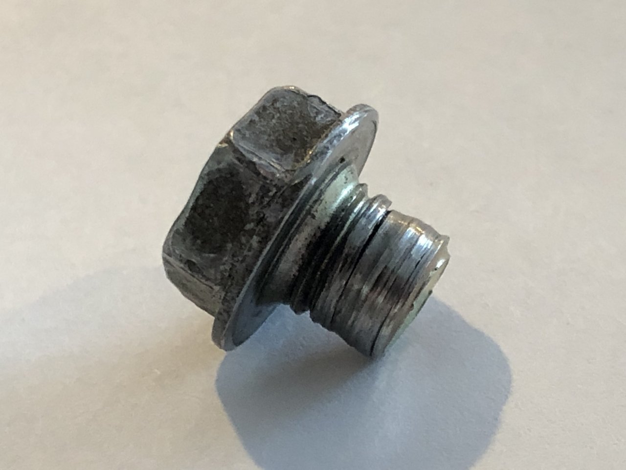

    1996 Tacoma 3.4L V6 2WD 5-lug AT 5VZ-FE
    My trans drain plug 9034110006 I've determined should be a M10 x 1.5 and only has like 4 threads. Any longer shaft might hit something. That piggyback oversized plug looks nice but I don't think they make this size.

    You have more options than you think- Maybe try looking for a mobile welder? Drop the pan, get the welder to weld a plate or bolt in, etc... Someone out there will help you. There has to be a fab or machine shop with a welder.
    RE fluid- I successfully did a drain and fill with MaxLife. It has mixed fine with the original OEM non synthetic.
    Don't over think the amount- Put a catch can under there- If it's metered, then it's easy- if not, just make a mark on the side of it, empty the catch can, and then refill it with new fluid and pour that amount back in once the pan is fixed and sealed back up to the transmission. I drained 4qts from the pan.

    Done! The pan hole was fine after a tap repair and taking care to get the shavings out. The plug was the main thing that was gone. I don't know how it was even staying in there at all with no threads.
    edit: Also it was roughly 3 1/2 quarts to drain and fill. Bolt size confirmed M10x1.5. It's running fine with Maxlife mixed in with DEX-VI, and Lubegard added.
