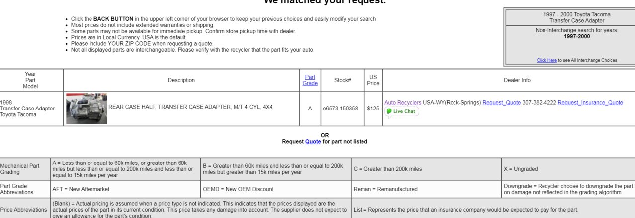

    Ahhh ok. Yep into the transfer adaptor housing. Not going to have fluid in it unless that seal is leaky.
    I wonder if you could use a longer bolt and then just secure with a plate and lock nut on the inside. Sketchy AF but with 3 good mount bolt it might still be ok. Those mount bolts are 48 ft lbs so not super high torque. You'd just have to secure the trans mount prior to install of the tcase.
    Not sure which I would try... bolt/nut or helicoil. I had to bore out one of the transfer case bolt holes where it mates up to the transmission. The housing was damaged during shipping but it also didn't have any threads - it was one where the bolt passes through and threads into the trans.
    Sux man. Hopefully you can work up something. Good luck.
    EDIT: If the OCD hits you like me and its really bugging you (DIY repair of that bolt hole), just start shopping for a replacement transfer adaptor. Might be able to find one at a local yard for cheap.
    https://www.ebay.com/itm/284507160988
    That seller also has it up on car-part.com for 50 bucks cheaper. If you go that route, call them direct.
