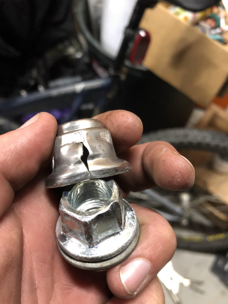

    Also interested if its the socket spinning on the lug nut? Also I have stripped a lug nut before and ended up breaking off the outer chrome part of the lug only to find a smaller nut inside and I was able to get it off the wheel. I don't think my lug not terminology is up to par, but here is a picture. If you are able to break the outer casing off, you should be able to get another shot with a smaller socket.IMG_0369.HEIC.jpg
