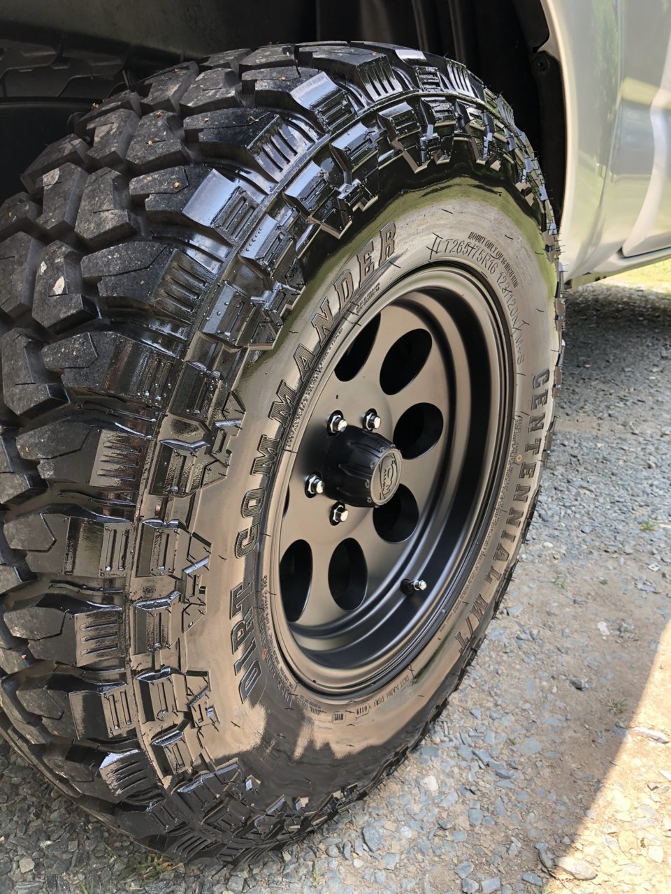

    The best tire cleaner I have found is Shine Supply wise guy tire cleaner and it's not even close to the second best. I can not believe how good this stuff works, it will blow you away. The brown tire bloom will melt away with this stuff. To test it I cleaned a tire with bleach white cleaner, then simple green, dawn dish soap, and purple power til they couldnt be any cleaner. Or so I thought. I the hit that tire with some wise guy and the tire was instantly oozing brown liquid and it took 2 more spray, brush, rinse cycles to get all the bloom out. Only place to find it is shine supply website, its $30 per Gallon, and that gallon is the diluted down from anywhere from 1:1 to 10:1 depending on how dirty your tires are. You won't regret buying this, just do it. Tundras.com members have a10% off coupon code shine supply ;)

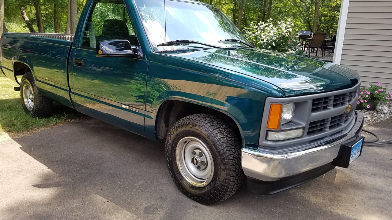

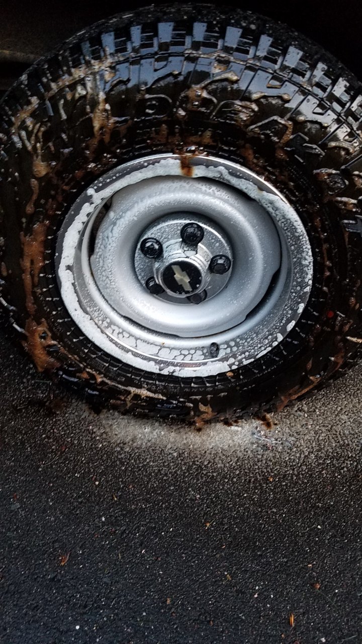

    Back in early July I did my brothers truck's tires with wise guy then optimum tire coating. The tires still look wet and glossy like this. That brown stuff it not dirt, its tire bloom being removed from the rubber pours.

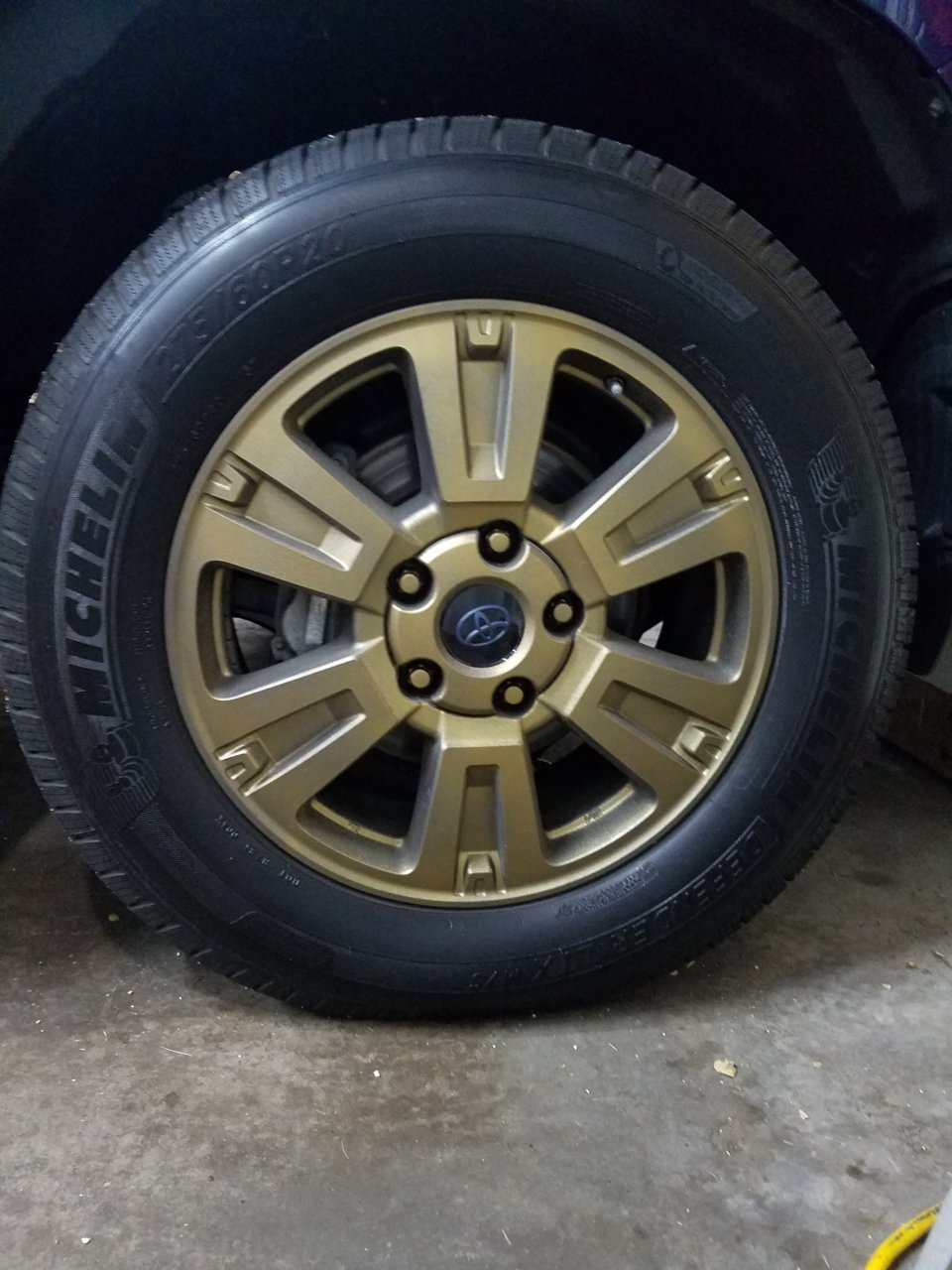

    And here are my tires 3 months after putting optimum tire coating with no touch ups. The only thing I have seen remove the coating is curb rash
