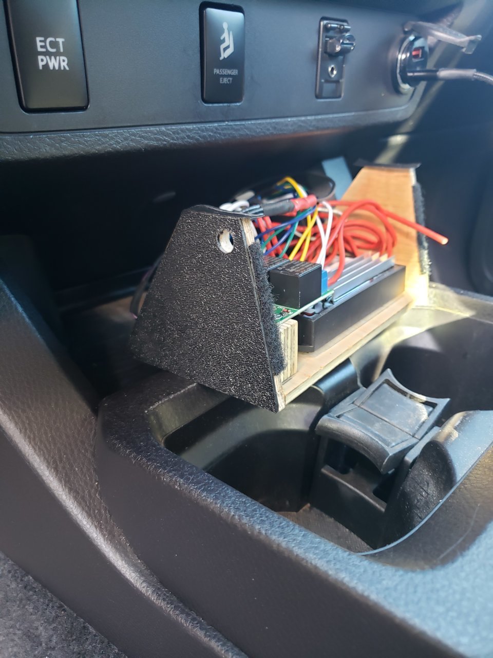

    I finally got to use my strobes at the jobsite last week. And then I realized that during the daytime it is difficult to tell if they are off or on (besides the switch being illuminated).
    So the strobe module I bought has wires for 6 lights. I am currently only using 4, so I figure I can add an indicator light to one of the unused wires:
    Gotta test the brightness tonight, but it's only supposed to be 5 lumens.:bananadance::bananadance:

    It's also helpful to show what pattern is being selected without walking out of the truck, though 2 indicators would've been nice (left & right) since I have my lefts and rights set up as alternating. This is the one I installed:

    @slowpoke16taco where did you get the connectors and pins to make the harness?

    I found them on AliExpress (though I think I read somewhere here on TW that the dealer sells the set of connectors + pins?).
    90980-12767 13PIN Female automobile connector plug shell and terminal: https://www.aliexpress.us/item/3256...tewayAdapt=glo2usa4itemAdapt&_randl_shipto=US
    90980-12766 13PIN male automobile connector plug shell and terminal: https://www.aliexpress.us/item/3256...tewayAdapt=glo2usa4itemAdapt&_randl_shipto=US
