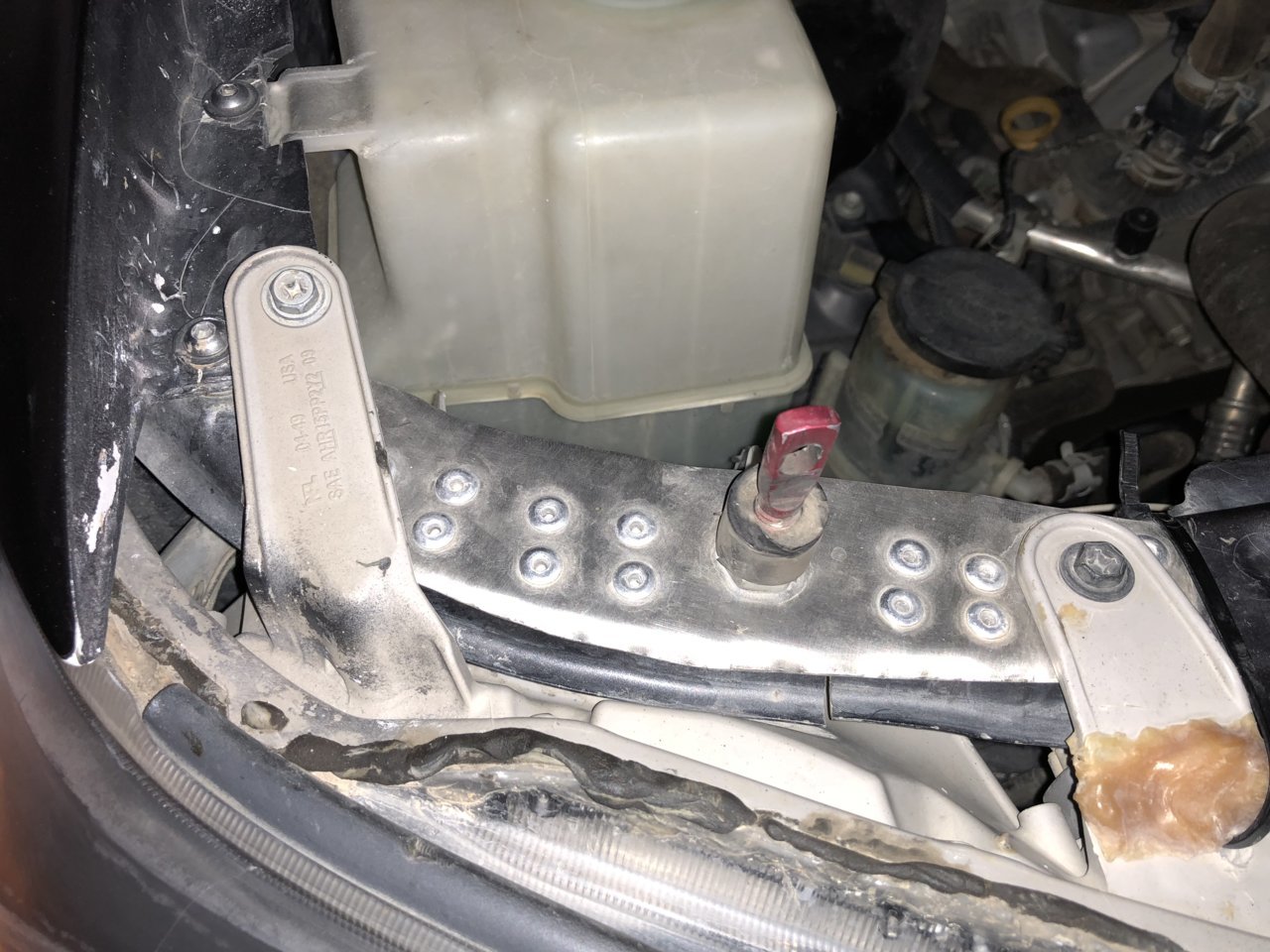

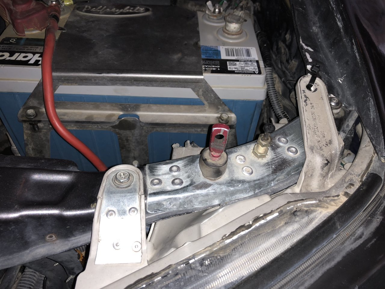

    I had to do this. Aluminum plate on both sides riveted in because that shitty fucking core support. Mines gonna be gone soon.

    Oh shit. Yours split in one spot entirely. How is that aluminum plate holding, good mod? How thick of plating did you use at that? These supports are soda can thin man it sucks.

    Haven't been able to commit to doing the hood latches either. My support split almost all the way through on both sides, so bought the replacement, cut the ends off it and sandwiched those on top. The extra thickness where the hood stops make contact seems to help with the hood flutter. Good enough for now.

    Its holding like a champ now! Not sure of the thickness but id say twice as thick as what Toyota used. My whole core support and inner fenders are just getting the shit beat out of them. Ive got patches all over the place. Just did this https://www.tacomaworld.com/threads...-meetup-thread.217178/page-4079#post-17670128 yesterday to fix my drivers side inner fender

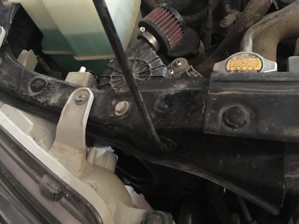

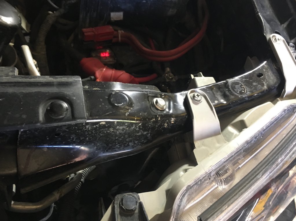

    Interestingly enough, I had this issue as well when I did mine tonight. Do you have any pictures of what you did as far as slotting the hole goes and placing fender washers in the setup goes? It would be really helpful. Thanks in advance.

    I just slotted the hole in the direction I had to move it to get everything to line up. In my case I had to slot the hole towards the cabin. I just threw a fender washers on the top and bottom. From what I'm reading even fender washers aren't enough support and the whole thing has to be reenforced. I'll likely just weld on some strips of steel when I get a chance to, but for the time being hopefully this will hold.

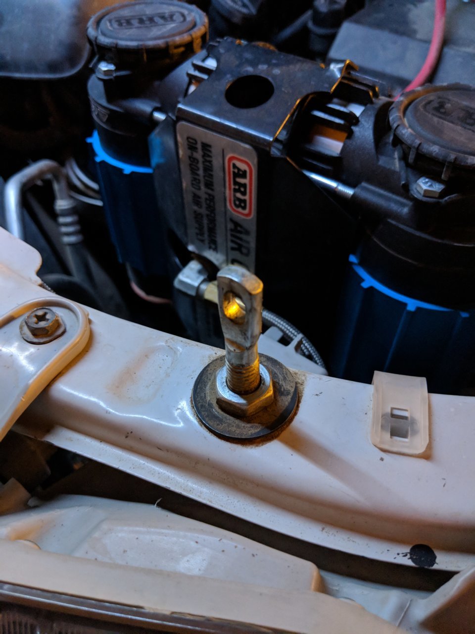

    Mine sits perfectly straight through the hood latch hole. Despite that the pin needs to move back and be a little more tilted for some reason. I have to apply a lot of pressure to the sides to close the latch otherwise, I do like the way they look and function though. Really cool and they do actually hold the sides of the hood evenly to the fenders now, so that's a big plus.

    I haven't driven it with them installed yet, but they seem incredibly solid. After I get everything good to go and on the up and up I'm going to spray some white lithium grease on the inside to ensure the mechanism inside the latches does not seize up. For now I gotta find tune the pins themselves and see if I can get them to go through the latches easier.
