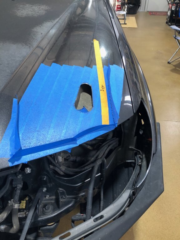

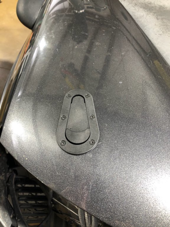

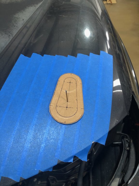

    Finally got tired of the hood ready to fly in my face and decided to install the latches that have been on the parts shelf for a couple years. I was also replacing the trashed multi "restoration treated" headlights so no better time tackle both. Many thanks for this thread and in particular @Airdog and @Sandman614 for their write-ups. My AeroCatch didn't come with a template so their input was above and beyond appreciated. The AeroCatch website has "instructions" that are pretty much useless, don't even watch the youtubes instructions. However, the drawing does point out that the hood pin is located just over 1/2" (14mm) from the center of the 1 3/4" Big Hole which is where problems can happen without the friggin template. I ended up making a template which worked off where the hood pin came through the hood. Hope this makes sense...
    This is a PITA install, somehow the Dorkel was less stressful.
    EDIT: Having seen @Sandman614 recent tear through I did reinforce under the upper radiator support with a couple inch piece of 1/8" steel.
    Bit sticking through the homemade template with center points of the 1 3/4" and 1 1/8" circles marked.
    Holes cut and connected.
    Installed per Airdogs instructions.
    New headlights, latches and a very badly sun beaten hood wrap...

    Excellent work and it looks great!! Glad I could be of help. I agree with you that cutting up for these can bring up some anxiety. Such bullshit that they dont include a template printed into their lableing anymore....especially since the holes are so close to the edge of the cut to begin with.

    Thanks, between your and Sandman's posts I was able to figure out the problem. Believe me, there were more than several beers consumed along with unreal strings of expletives...

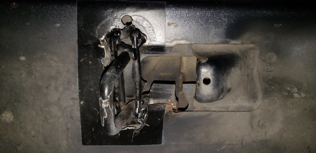

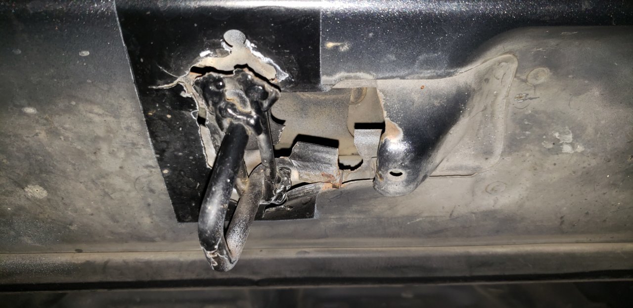

    Just a little update....so the core support is gone along with the hood latch on the hood side breaking off completely, so I did this a few months ago since my hood staying closed now relies on these hood latches. Though the hood safety catch is still in working order. Also the aluminum catch rods break easily...ask me how I know. I ordered the steel ones from summit for a really reasonable price as compared to aerocatch's price and eliminated that problem too.

    Just installed these latches this afternoon thanks to a great write up by @Airdog. Many thanks!
    My hood developed a 1/4" gap and associated flutter about 2 years ago when I left it propped open for about 2 months in my garage working on some other mods and it twisted under it's own weight.
    This past August things seemed to get worse when I had trouble closing it a few times and noticed that part of the catch inside the hood itself was rusted through. Someone who knows how to weld would probably have just tacked this up and called it a day (which I may still do) but for the added security I I the hood pins.
    I still have a pretty sizable gap on both side by the fender, but the grill lines up perfectly and I can relax my fears that my hood is going to let loose randomly. I am definitely going to have to reinforce the core support considered its already cracked almost halfway through on both sides, but that's a problem for another day.

    Your welcome.....but that core support wont last long with that crack and the hood pin there. It will be broken in half before you know it. After I did the initial install in about a year that part of the core support broke all the way thru. I had to sandwich it inbetween 2 peices of metal and rivets to fix it until I ended up completely replacing my core support with tubes and now the JDfab inner fenders.

    I honestly wasnt surprised that it twisted being propped open that long. But the core supports...c'mon toyota. I really feel like they missed some huge opportunities to improve on the 2nd gen platform structurally and mechaniccally with the 3rd gen.
    I fully anticipate this will blow apart soon if left unattended. I did see the pictures later in this thread showing what you did in the interim before the JD fab stuff. I will probably do something like that in the meantime time also until I figure out a long term solution.
    I saw in another thread where someone sandwiched a good core support on top of a bad one, which seemed to hold up for awhile.

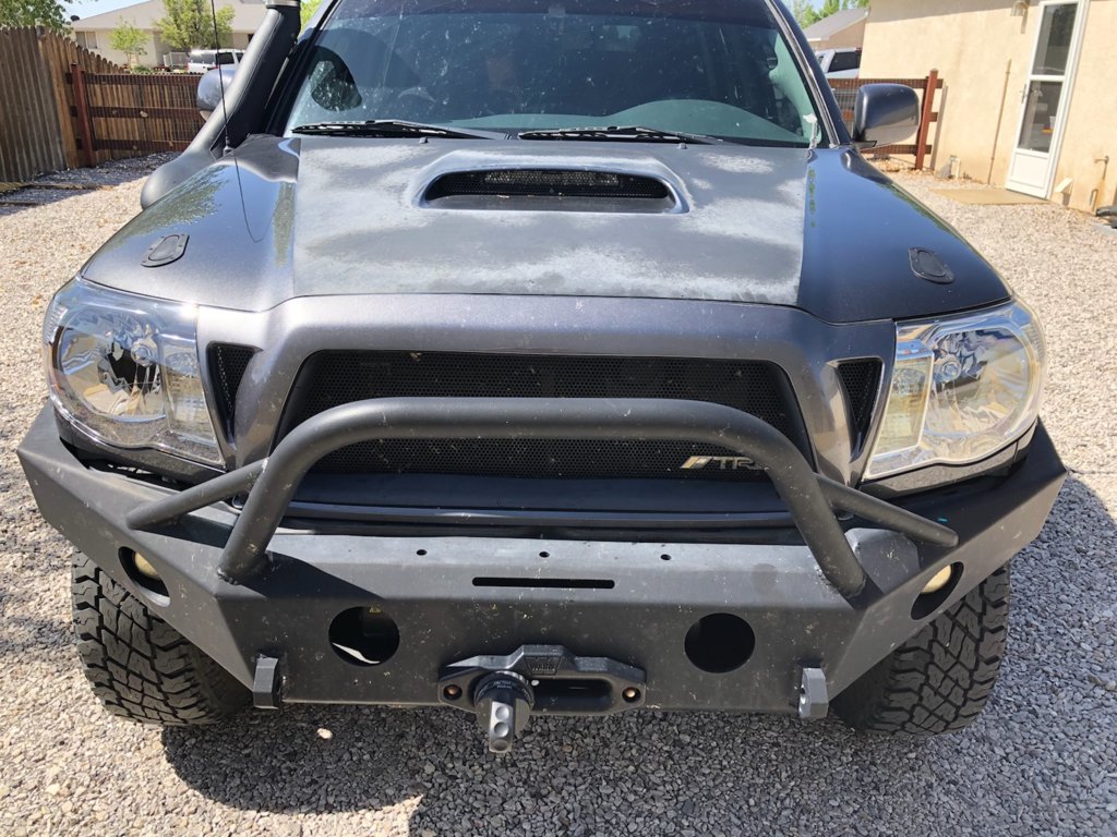

    Well creeping up on 170k miles, many of which have been off-road driving, Toyota's fine metal selection has finally given way even after a bandaid weld several years ago. Found this thread searching for failed hood latch. I've already got the failed core support too. I love Toyota trucks but they really cheap out on the engineering and tin metal they use on the front end.
    The rubber bungee did pretty well for added insurance on the way home from a recent Death Valley trip.
