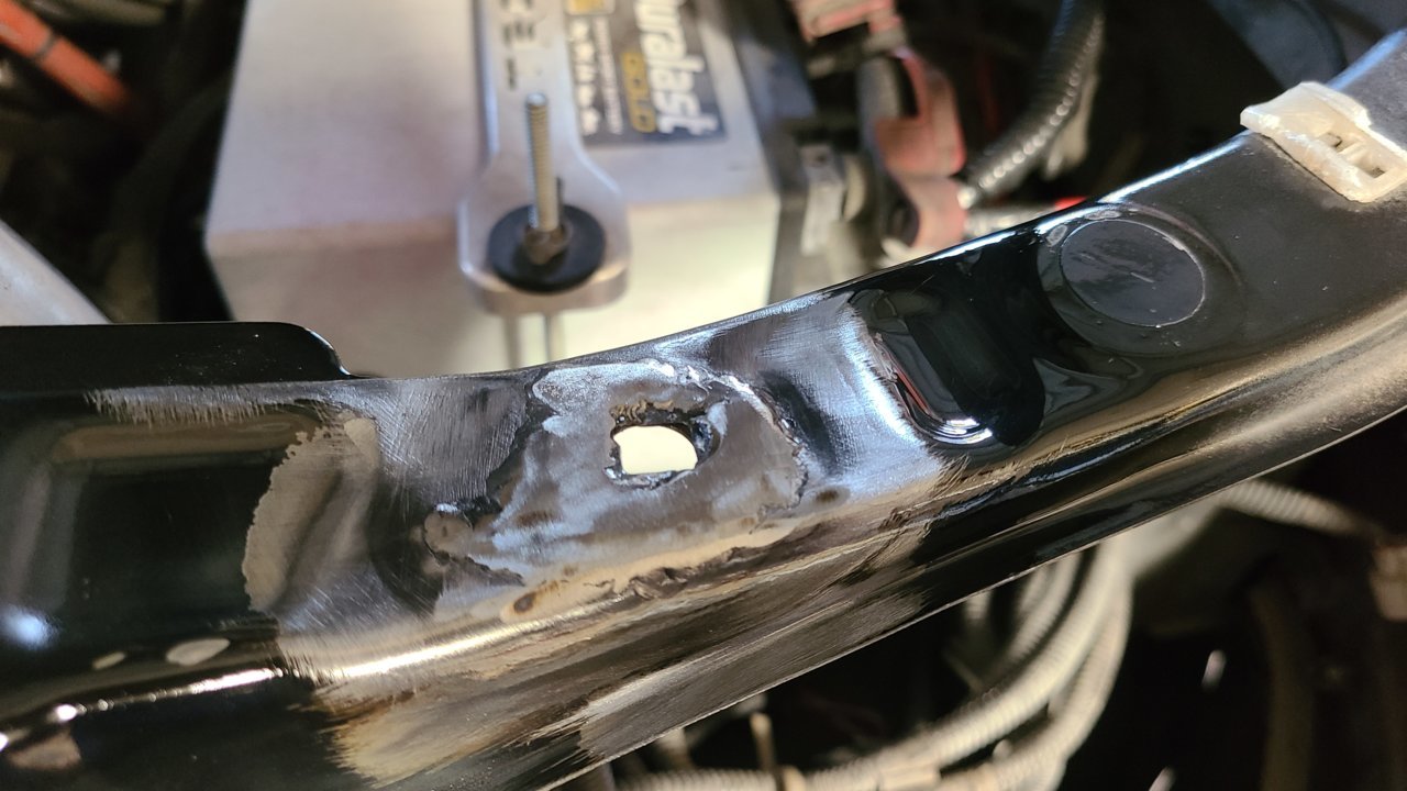

    Looked at the date of your first post was 2015. Where you quoted my photo. I'd have to do more digging to find the specific date of when I actually installed the latches. From your post however, that is roughly 7+ years going strong with the aluminum pins.
    There are some slight notches in them. The main problem that I have encountered, is that the stress on the core support had caused the driver-side to crack. I had to re-weld that back together. Super thin sheet metal, coupled with the wind vibrations over time.
    I think I repaired the area around the pin about 2 years ago now.

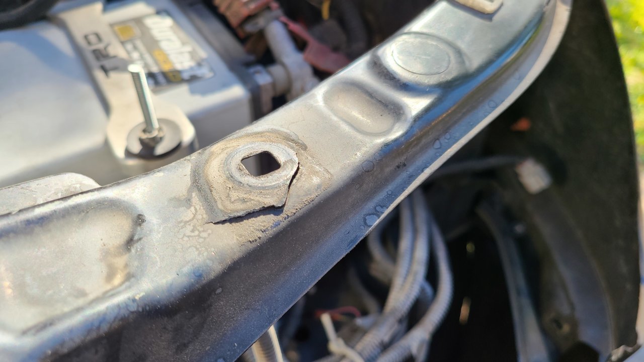

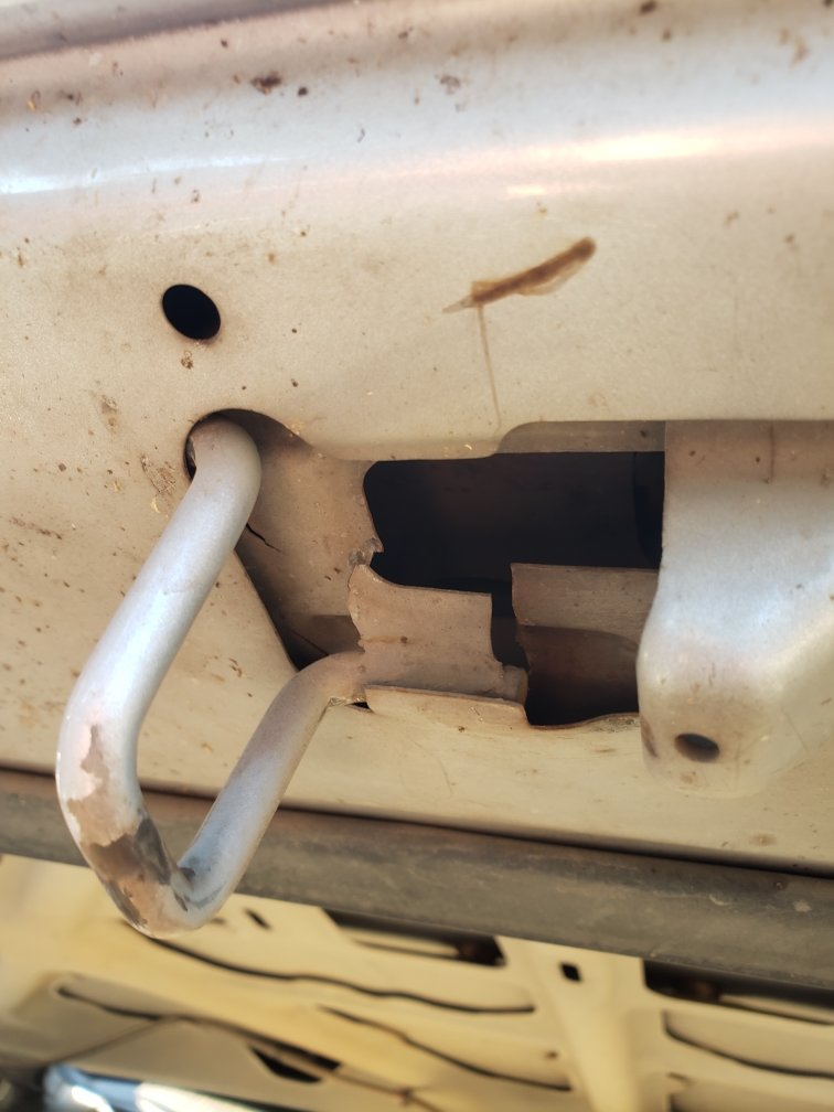

    Mine finally let go too :/
    Don't think I can do the pins, I've never had a hand-drilled hole line up in my life.
    Drainbung and Airdog like this.

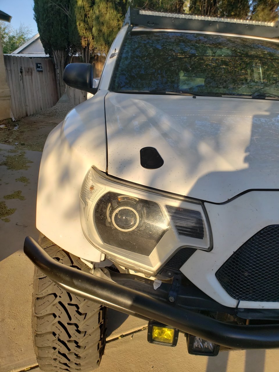

    Rubber hood stop adjustment or wear issue. And/or that damned fake hood scoop on the trucks that have it may also contribute to hood flutter. (My 2014 TRD-OR has a normal, non-fake hood.)
    On pavement I've hit 110mph briefly (down hill,) and extended runs of several minutes at over 100 mph on the flat -- and never seen a hint of hood flutter.
    Even doing 70 mph on single-track bumpy dirt forest roads, no hood bounce or flutter that I've ever noticed.

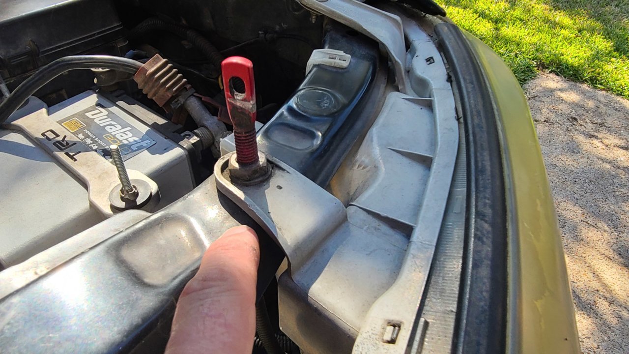

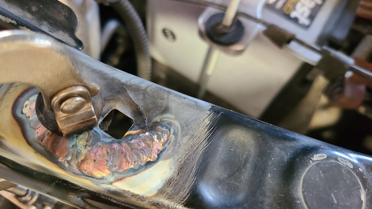

    I definitely think the stoppers and adjustment are part a big part of the equation. I don't think the scoop matters. My hood that failed exactly like @mk5 above was a non-scooped version that I actually traded in my scewped sport hood for many years ago. No doubt it didn't line up like the original. I think it's just a matter of a) ever truck is different, and b) things that shake and rattle tend break or wear out faster than things that don't.
    Since reinforcing my cross support and putting these latches in, my hood has stayed perfectly right and tight. At least as close as it's going the get at this point.
    I really do like these latches. There's just something about pushing that button, flipping the latch, and pounding my fist on each corner of the hood to release the tension on the pins that I find satisfying. Maybe even...cool :cool:
    @mk5...measure twice, three times if you have to...have someone you trust check your work and whisper "you can do it" in your ear. Make a template if you dont get one in your kit. Mask out the surface in tape you want to drill/ cut. I went as close to dead center with my pins through holes for the adjustable bumpers so it was easy to locate on the hood and cross support.
