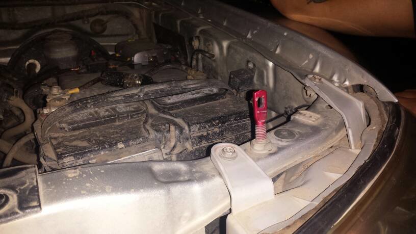

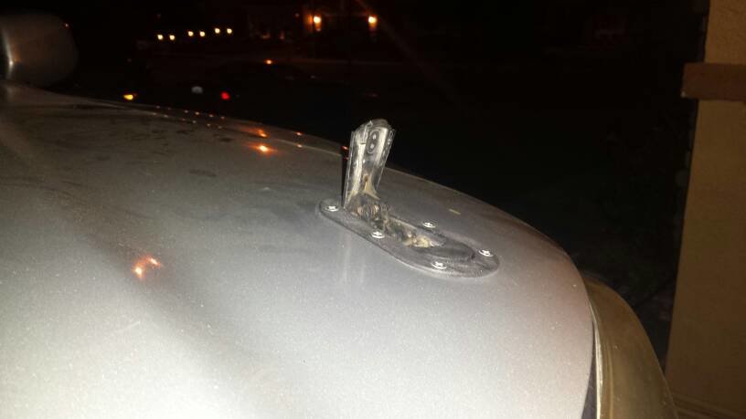

    Sorry terrible night pics i just took. Members truck: Supratrippy

    I'm liking how they are mounted on this one compared to sideways, I'm wondering why he didn't just use the existing holes off the rubber stoppers though? It would had been easier that way and that's what most other people do. It also looks like he's using a stock metal hood still as well.

    Yah its a stock hood. Mounting is just preference. He also didn't use the bottom "sandwich" plate either. Switched bolts out for small metal screws instead to avoid cutting a massive hole underneath the hood too and compromising the integrity of it

    I was noticing there weren't holes at the bottom of it. I wonder how that would affect its overall hold down strength.

    I've known him for awhile and been through some pretty serious mobbing with him and they have never had an issue. They are also primarily holding all the pressure from the hood because the center latch is useless on his truck
