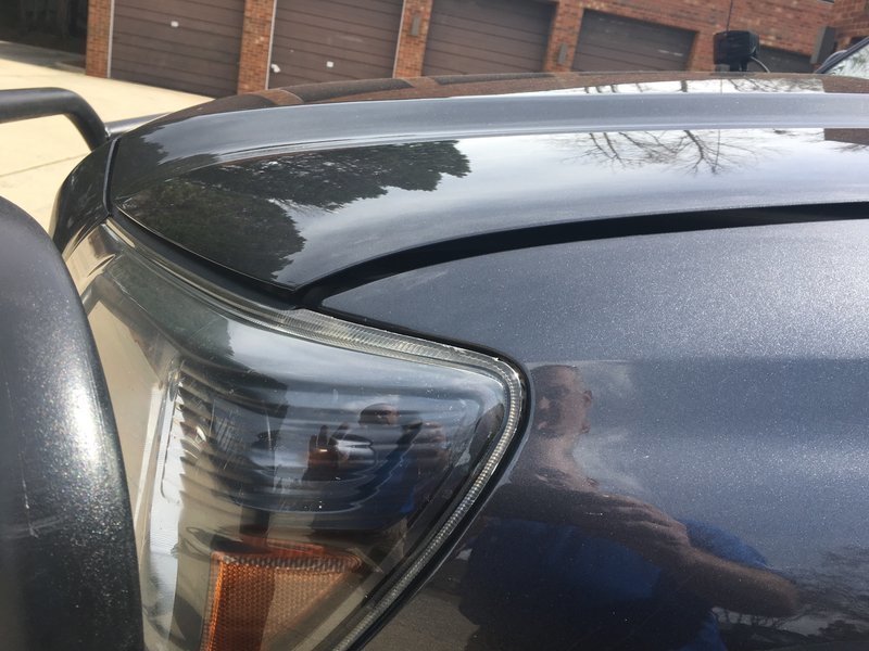

    anyone who has this issue, how much do you offroad, and whats your armor setup?
    2015 access cab, TRD OR, I am full plate front, full skids, sliders, and ditch light brackets.

    weird. ive only had it one time that I know of. that was with hurricane winds at my face while going 75 or so. I seriously thought my hood was about to pop open. is there a way to adjust the hood latch down so that youre not maxing out the rubber hood adjusters?

    Idk. Maybe. Hood is ok up at windshield but could somehow be related

    Not sure. I looked at that hard the ither day. Center of hood ok so not sure I want to mess with that one

    so you may have a bent hood? if its good in the middle, it should be good on the edges too right? that is a looooot of gap along the edges
