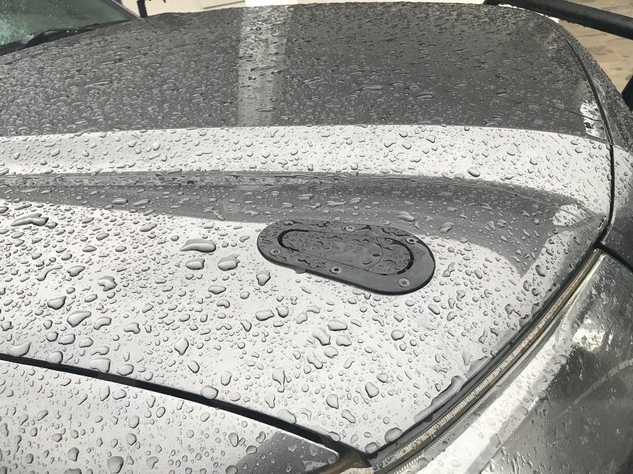

Strongly considering hood latches

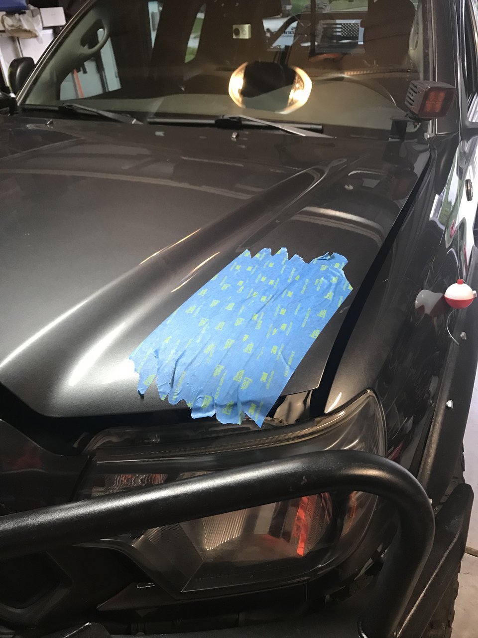

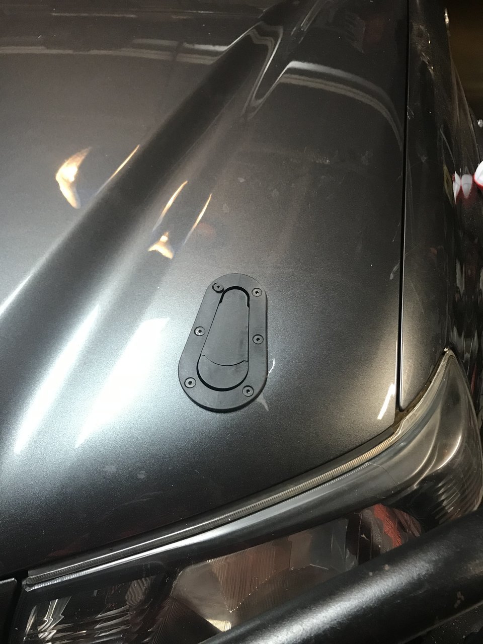

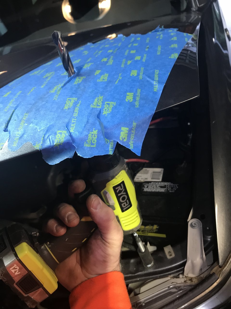

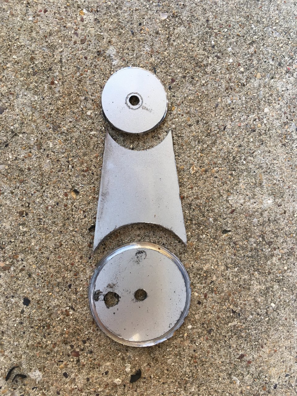

    Thanks! I used 1-1/8” and 1-3/4” hole saws, and a Dremel with a small metal cutting disc to make the straight cuts. I was going to use a jig saw, but the blade traveled too deep and so it would have contacted the inner sheet metal layer of the hood. For the hole saws I’d recommend using ones that have a pilot bit extending beyond the main saw teeth to help keep your cut on target. I had one of each type of hole saw, and the one without the pilot bit was much harder to keep on target. You can see one made a much cleaner cut:

    Those are pretty clean cuts.
    Did you use the holesaw in reverse at first to get a groove going?

    Nope the thought never occurred to me :tinfoilhat:

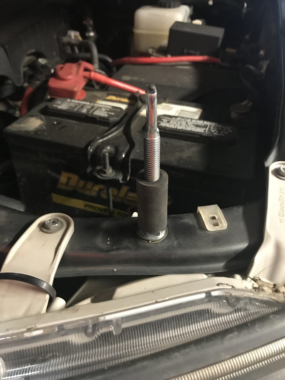

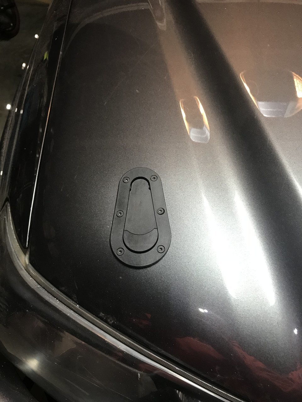

    Did this this weekend. not too bad of a job. other than the ripped fingernail, and grinder to the digit. stripped a few bolts, will replace. still need to adjust a bit, all in all pleased.

    Those look good and your hood looks to be properly aligned!
    Any pics of the cutting process? ​

    Ha, no. thats all i got. I hacked it up good, but not to much visible damage :anonymous: hole saw walked on me on the driver side one, will touch that up. no more hood gap, need to adjust a tiny bit, but will be all good
