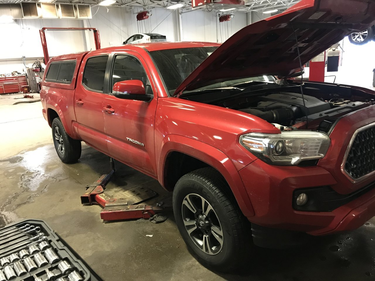

    I had one come in a couple of years ago.
    Took out most of the ecu’s.
    A little burned wiring.
    Took a lot of systems diagnostics. Lot of time.
    Don’t try to play with it. That’s what insurances for..
  7. Jul 29, 2022 at 8:41 AM
    Tacoma Mike
    Aug 6, 2011
    #61230
    31,358
    Southern Maine
    I called the truck lightning
    This is where it got hit.
    lynyrd3, jackn7, wilcam47 and 4 others like this.

    Something like 12,13 thousand by the time I was done with it..
  11. Jul 29, 2022 at 8:50 AM
    Tacoma Mike
    Aug 6, 2011
    #61230
    31,358
    Southern Maine
    Kinda close…. Wow…

    It came out the RF Rim.
    After I was done with it I told him your going to lose your rf wheel bearing at some point.
    After i retired it came in 6 months later. Bad rf wheel bearing. Wouldn’t cover it even though I made notes for the poor guy..
