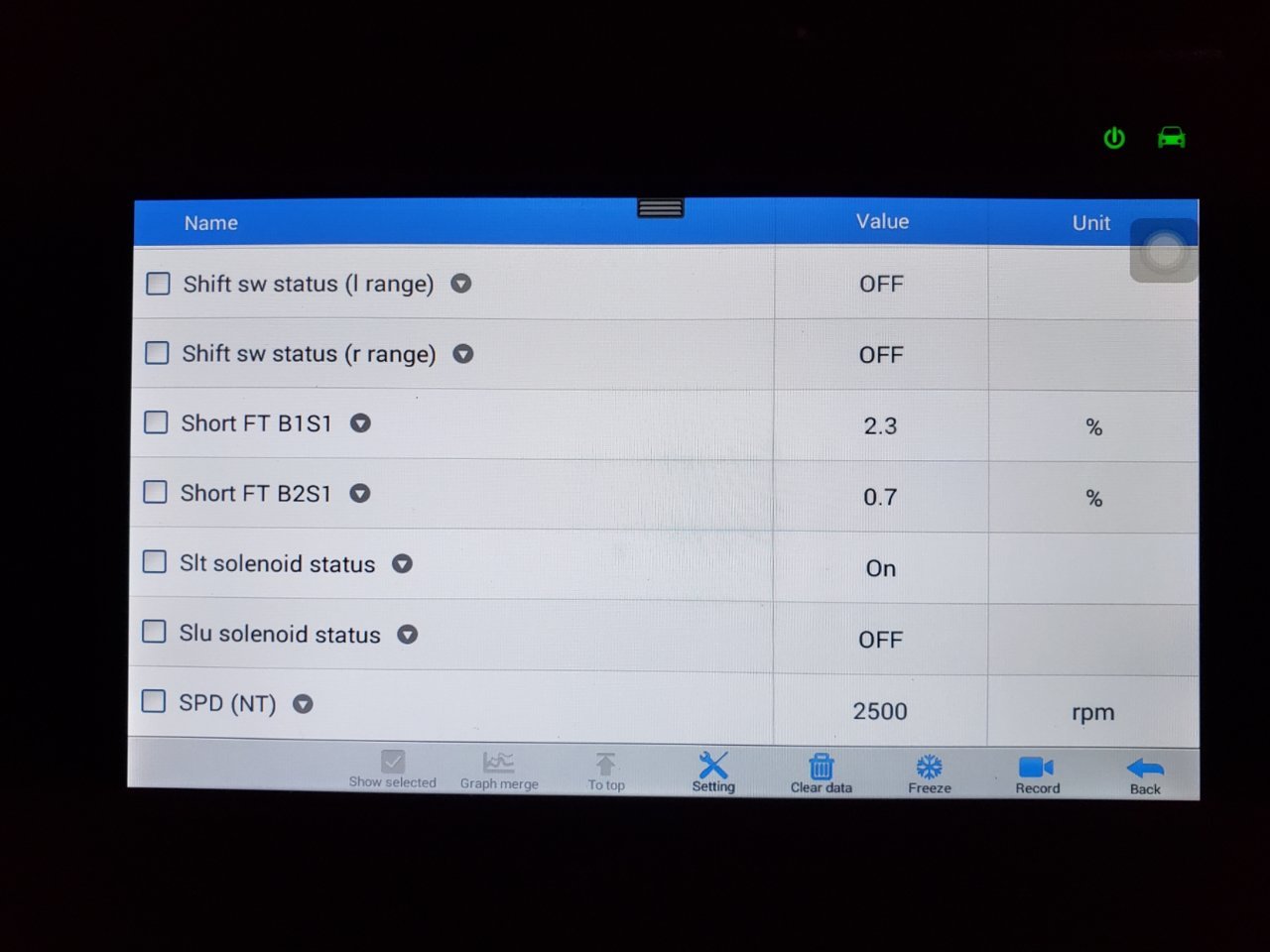

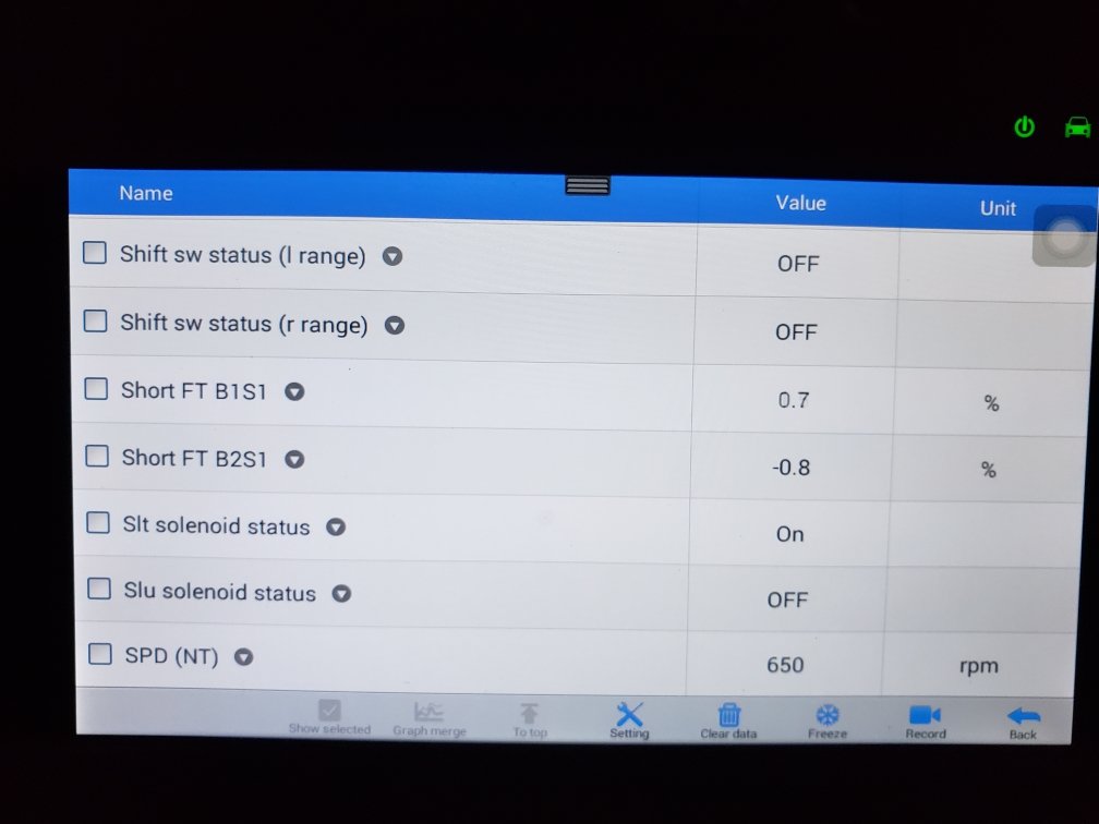

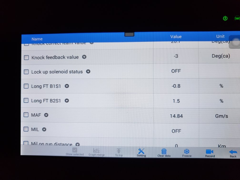

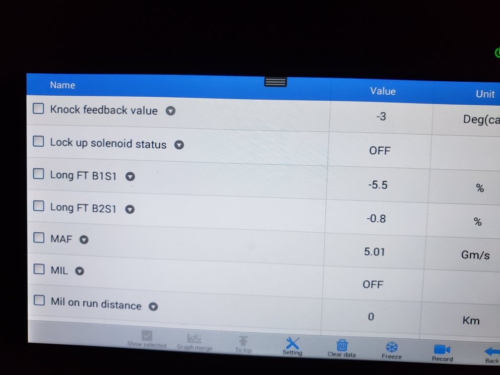

  17. Jan 11, 2019 at 8:36 PM
    #57
    Chandler
    Chandler [OP] Member
    Dec 20, 2018
    #276425
    8
    Chandler
    2006 tacoma 4x4 long bed trd
    I am still getting 12mpg.
    I have Installed a volant CAI, replaced the air filter, did a fuel trim test, and tried Premium fuel.
    fuel trim test. first 2 pictures >idle<
    fuel trim test. second 2 pictures >2,500rpm<
