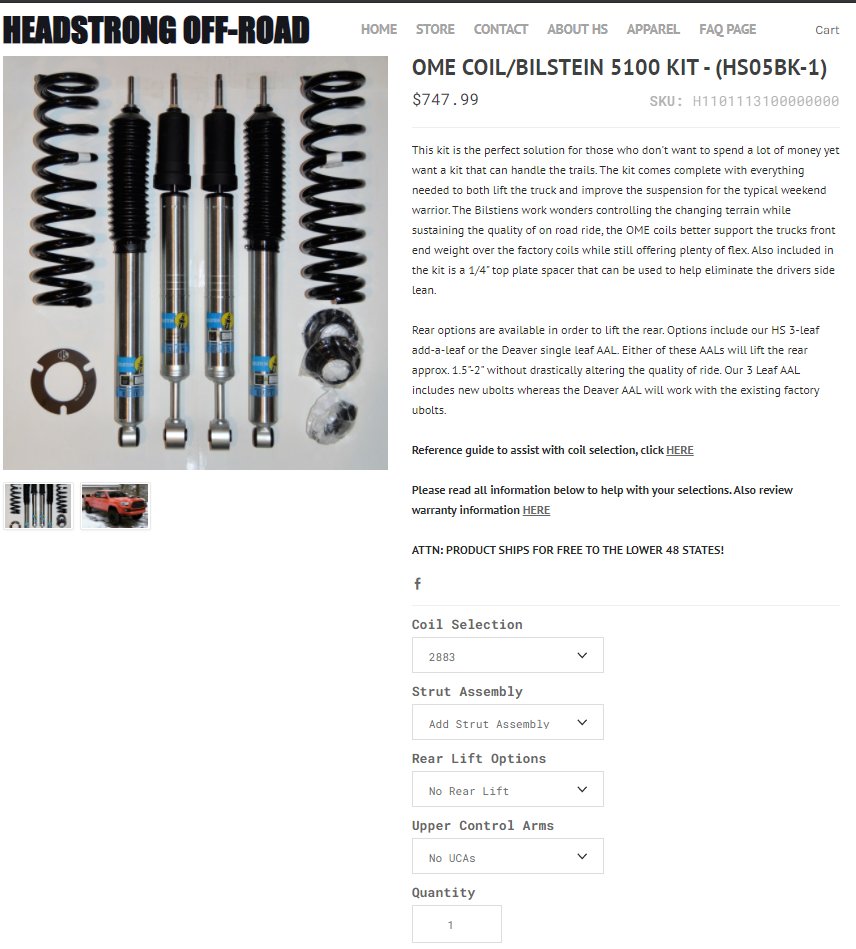

    Do you mind doing the labor yourself? If the struts are assembled, it's a pretty easy job.
    You could hit up Marie @HeadStrong Off-Road and get yourself something like this:
    Spencer97TJ[OP] and TnShooter like this.
