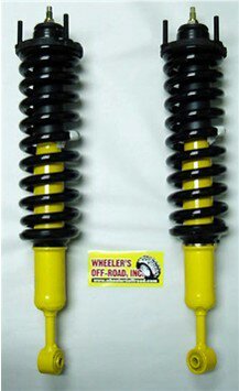

    This is what a pre assembled unit looks like if you just swap the entire thing out. The top hats do not stay with the truck when you do it this way. The top hat is what keeps the coil on the shock.

    Yes, the top hat does hold the coil on the shock, but there is no reason it can't be reused. OP needs to disassemble his 5100s no matter what, any which way he decides.
    LCA method is relatively easy and way safer than spring compressor. Other option would be to take both sets into a shop with a coil compressor and have them swap top hats.
