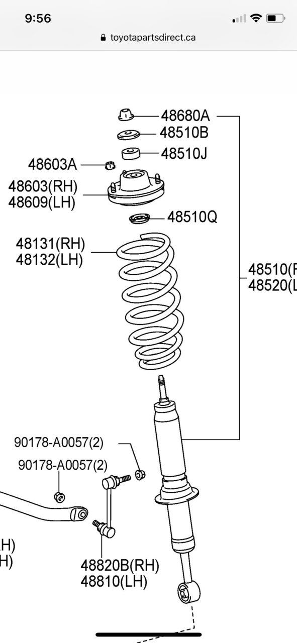

    Hey guys, I just got new struts and coils installed on my, and was wondering what the process would be like to replace the strut mount? Would I need a coil spring compressor and everything or just some basic tools?
    The parts I want to replace on the diagram are:
    48680A
    48510B
    48510J
    48603A
    48603 (RH)
    48609 (LH)
    Thanks

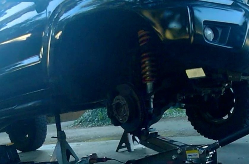

    Also pic of mine when I was putting my latest coils and struts in, no compressor. Just follow the steps in the video. To each his own, but it's really easy with no compressor.
    You have to get it aligned anyway, compressor or not.
    Edit... OOPS,
    That's pic of dropping the Rancho out with no compressor. But you get the idea.

    Just a side note, on install, with 800lb+ springs the weight of the truck wasn't quite enough to get the coil to compress enough to start the top nut on the strut. Had to have a friend who weighs about 250lbs stand on the side bar to get it to compress a little more.

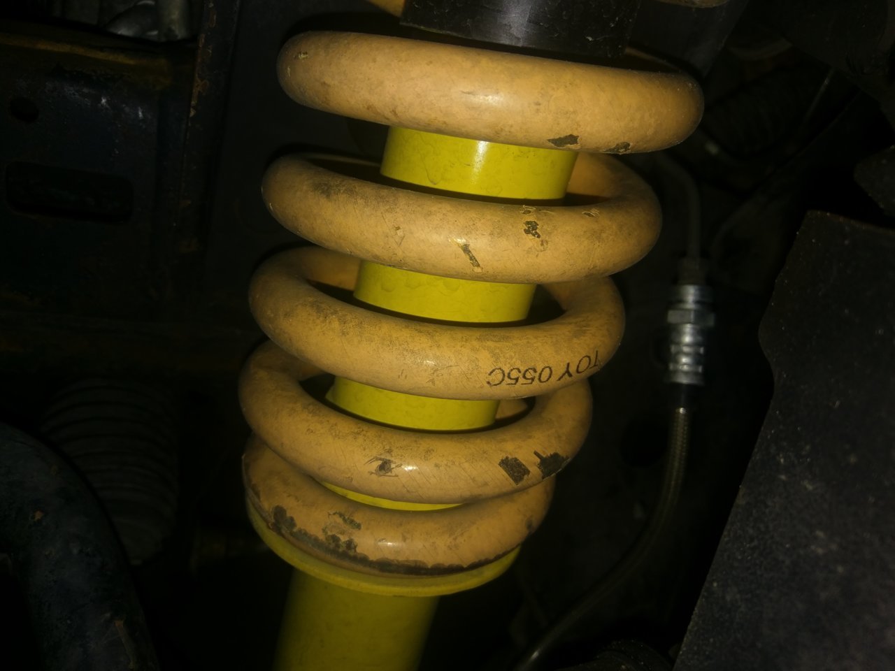

    800# springs? Lol. I bet the ride quality is absolute garbage without 300 pounds of armor up front.
    The highest available for the Tacoma are 700# that I am aware of and the weight of the truck works just fine.
  11. Sep 29, 2018 at 9:02 PM
    jboudreaux1965
    jboudreaux1965 Ragin Cajun Fan
    Jun 2, 2014
    #131162
    3,812
    Joseph
    Hub City
    2023 TRD Sport
    Never said they were Tacoma springs. TOYO55C.
    b_r_o likes this.

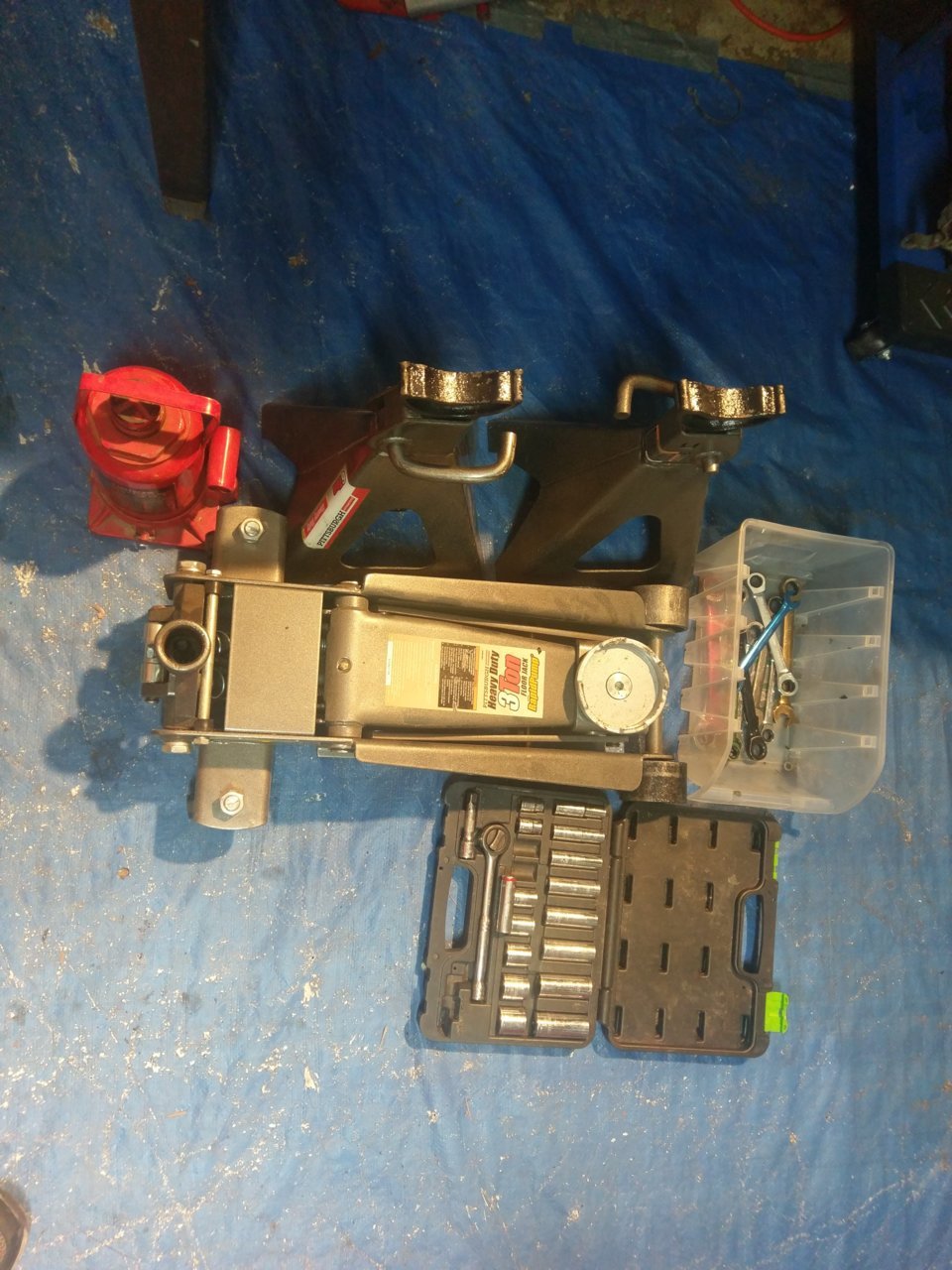

    If you have no issues, I'd leave as is man. If your like me and do over kill on maintenance, yes you can do it yourself.
    Need...
    Jack Stands
    Floor Jack
    Another Jack, bottle jack or OEM tire jack.
    Ratchet set. Set of ratcheting wrenches (pic)
    A couple hours time :)
    But the most important thing, you need to get an alignment done. Anytime you do work on the front suspension, change coils, struts, tires, you need an alignment.
    If your going to go ahead and swap the parts, do so and get it aligned after. If you leave as is, get it aligned.
    Sorry for the confusion bro!

    To do the job yourself... Min tools... If you had to buy it all $200. I think that's what you were looking for. If you have the tools... Free.
    But this is what you need...
    Biscuits likes this.

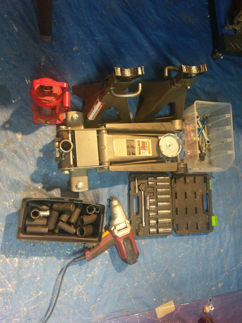

    To do it quickly add Impact and sockets... If you bought it all new to do the job about $300.
    BUT, my motto is every time you buy a tool, you save money on the next time.
    (these are pics of my own tools, what I used)
