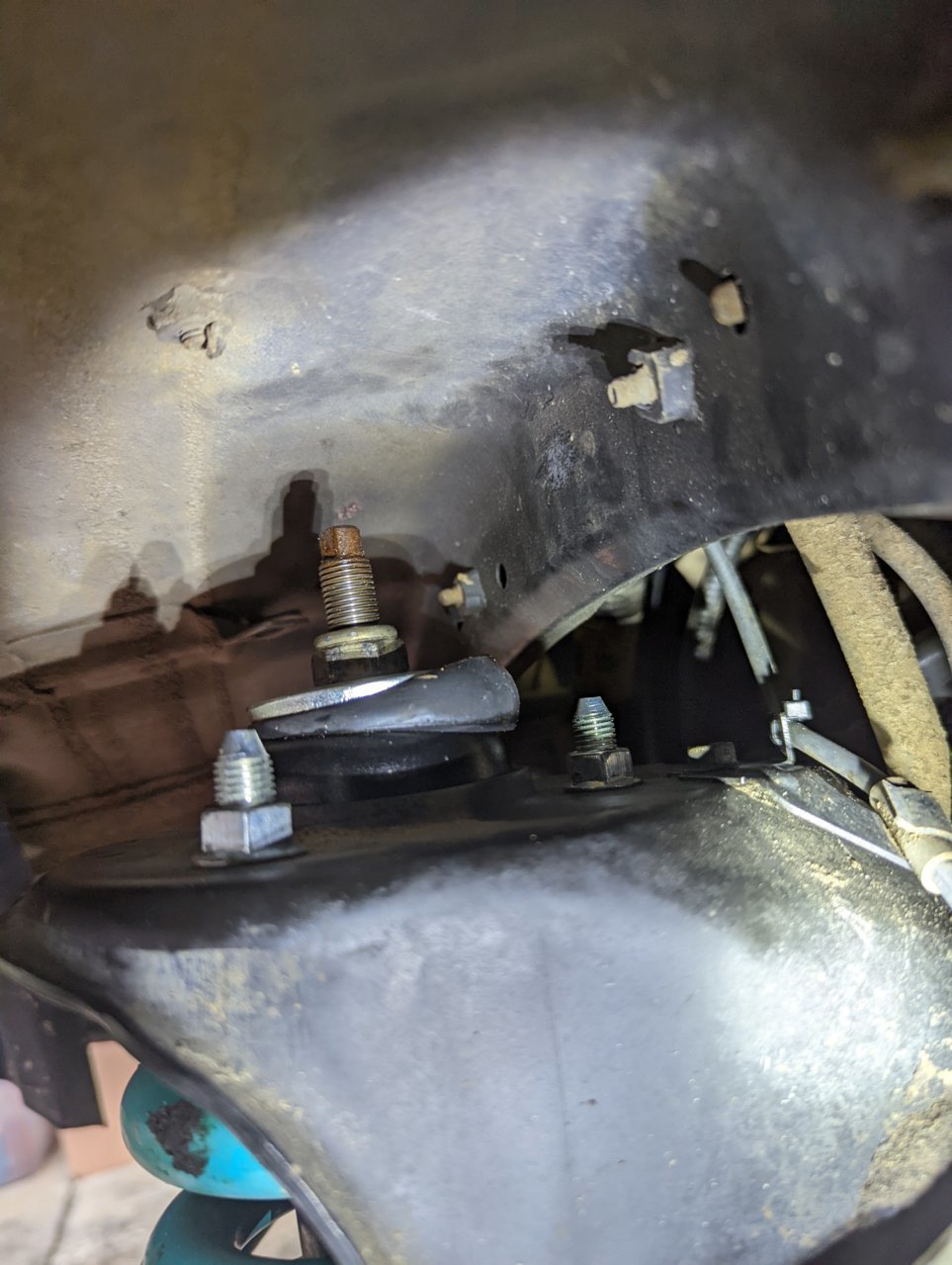

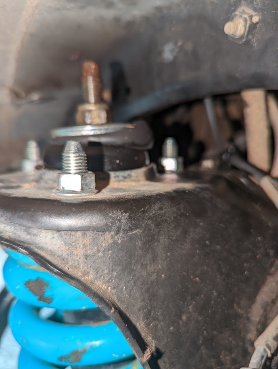

    Replaced my strut mounts a few weeks ago, then found out my ball joints were bad, so I'm replacing my ball joints and I notice the top strut mount bushing is all wonky already. Wtf am I doing wrong? I read somewhere on Tacoma world to tighten the top bolt until the bushing fills out the washer. I'm not sure there's room to get a torque wrench in there.
    Am I missing something here?

    I’m going off memory here but there seems to be way more of the bolt exposed than on my truck. Seems like that top nut was seriously over cranked and blew out the bushing.

    Only needs 3-5 threads showing, I count 13! :eek:

    There’s an actual torque value but that’s sort of an apparition since you would need to somehow use a torque wrench and simultaneously hold the shaft in place. Maybe tools exist to accomplish this but I don’t have them.
    One technique I’ve heard is to torque the nut until it turns the shaft. Visually speaking I would not want the bushing to bulge excessively.

    Dang, you really crushed those.
    Search Google/bing/ask Jeeves about a crowfoot wrench. That’s how you get a torque wrench on there.

    For most struts that I do (5100, 6112, stock) I run it down until it bottoms out. Meaning they leave just enough thread to where the nut actually bottoms out on the shock shaft.
    Dobinsons I have no idea how they want their shock assembled and how much to torque it. They rarely give good instructions, but I would try to find some. Maybe contact a dobinsons vendor on here to see if they can dig up install instructions. Including how the hardware is placed and torque specs.
