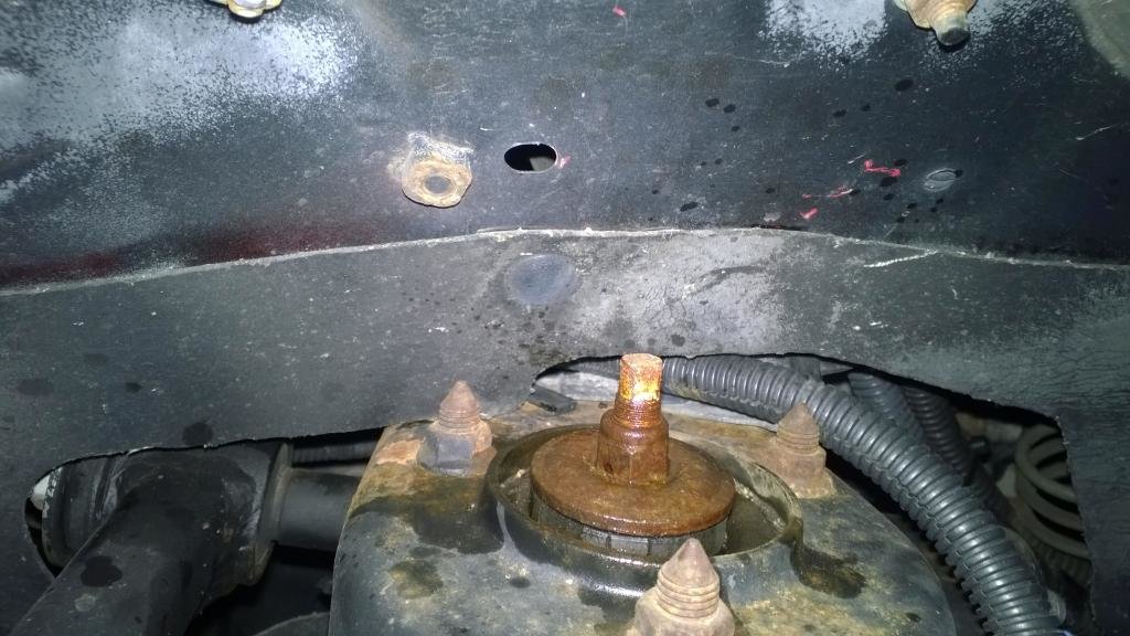

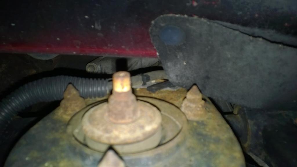

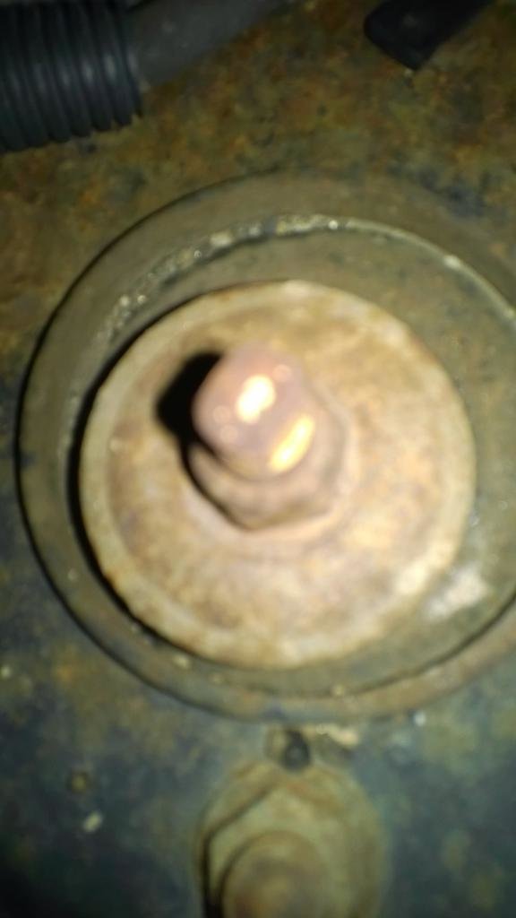

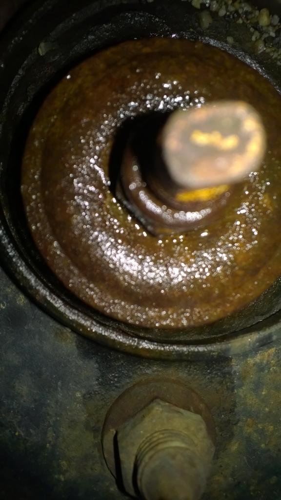

    So iv got this annoying high pitch squeaking going on on the driver side of my truck... I thought it was the upper control arm bushings but upon further investigation i found out that the squeak is coming from the top of my strut. The squeak is not constant per say... like it dosent happen on big bumps but on the little imperfections on the road. And its like a metal to metal squeak thats really high pitch. Anyway i tool some pics and notice that the middle of my struts are sorta off center in the spring tower as you will see below. What would cause this and how do i remedy this and is the offset normal?
    Driverside, i sprayed with wd-40 to confirm the location of the squeak
    Passenger Side

    The offset is not normal and eould worry me a bit. I think your strut is fine but you need to replace that top mount. I've never seen one wear like that.

    When I was researching on Old Man Emu how to field change front shocks and coil overs I saw where the top caps of the Spring assembly can get worn out in an elliptical pattern. Means you get to change out for new parts. Mind you..I have not done this myself. Maybe someone who has will chime in

    Do you think its just the rubber isolator that's worn out and not being able to support the strut? I should add that i do have the Fabtech 6inch struts, and also that the struts are in good working order and not leaking. Eventually i want to replace the shitty fabtech struts with either Radflo struts or the Trailmaster spacer/OEM strut modification, but im about to put new leaf springs and hardware in in the rear and dont want to get to deep into two things at one time.

    Can't tell without pulling that top mount off, but my money is on the top plate being worn and needing replacing. I'm not familiar with Fabtech lifts, but do they use the same top plate as regular Tacoma struts?
