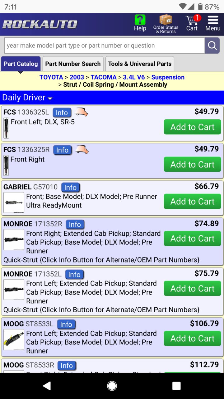

    0xDEADBEEF, thanks. I'm looking at the Monroe 171352. Is this what you're talking about?
    Kwikvette, lots of good information. I'll definitely look into that. Is there a way to check the ball joints? Removing them and checking for play?
    Taco critter, Erie County, so unfortunately loads of salt in the winters.
    Taco critter likes this.
  5. Jul 11, 2020 at 9:54 PM
    0xDEADBEEF
    Mar 2, 2019
    #285037
    19,828
    2000 reg cab 4x4 flatbed MT
    Yep, thats the one:

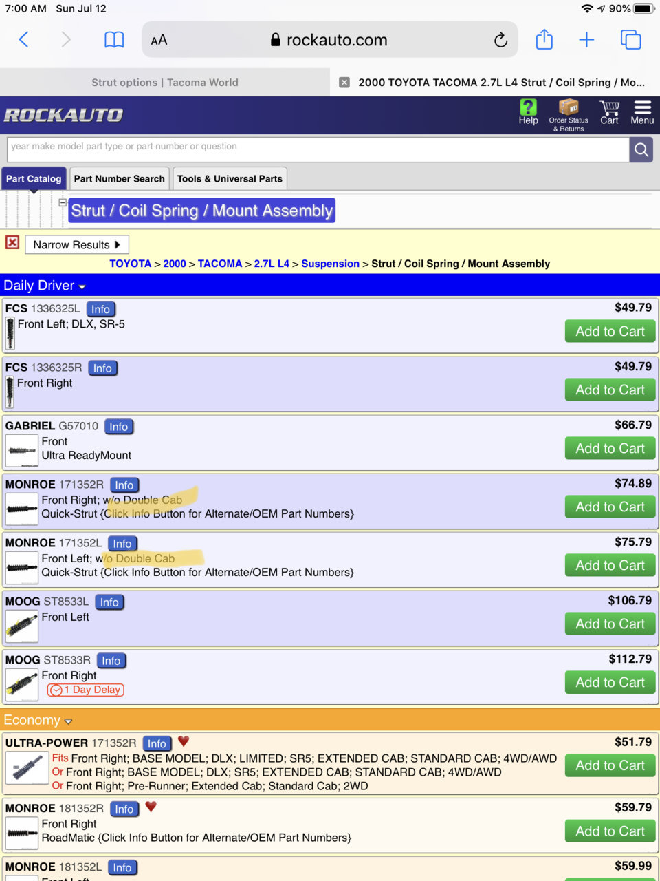

    Edit: I know this says 2000 but if it’s wrong for a 2000 DC it’s wrong for your ‘03
    If you go to Monroe’s web site and enter your info it appears they don’t make a Quick Strut for your rig. You would have to buy your springs separately

    Okay, I see. You have the 2.7 L selected. This is what it looks like for the 3.4 L:

    Double cab is not listed. I went with 171352 on my EC and love them but It stands to reason there can’t be a one-size-fits-all for all the permutations of single, extra and double cab x 4 or 6 cylinders. Spring rates and maybe dampening have to be different for the DC. According to Monroe 171352 will work for any 1st gen Prerunner or 4WD except 4 or 6 cyl double cabs. Check the Monroe web site.
