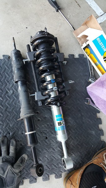

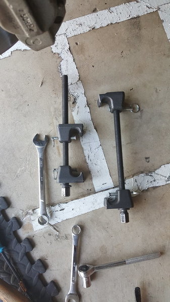

    14451152990211543392280.jpg I'm using these compressors with the safety pins I bought them at autozone

    yeah, I did mine with the treaded rods and hooks, ( Harbor Freight compressor ) It was pretty nerve wracking, as things got compressed I started holding stuff at arms length. working on the tail gate of the truck didn't make it any less crazy. ( I had new top plates to go with the springs and struts, so I put it all together a few days ahead of install )

    OP, I used those same compressors from AZ to install and remove OME 885 coils as well as remove and install the stock coils. They will work but can be dicey at times. Do the best you can to get them parallel to one another across the coil before putting them under load. Just take your time.

    GREASE THE THREADS ahead of the block, makes it a lot easier to turn the bolt and not gall the threads.
    tighten a few rounds each side at a time

    Good luck! Let us know if you get hung up on anything else. And make sure you get the spring cup on the billy's on the right way so you don't have to do it twice! You shouldn't be able to see the c clip of the spring if the cup is on right.

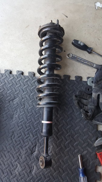

    1445119497927570521222.jpg alright guys it's out I'm gonna get the other side out right now can you guys tell me how to connect my 5100s to the coil? Thanks again

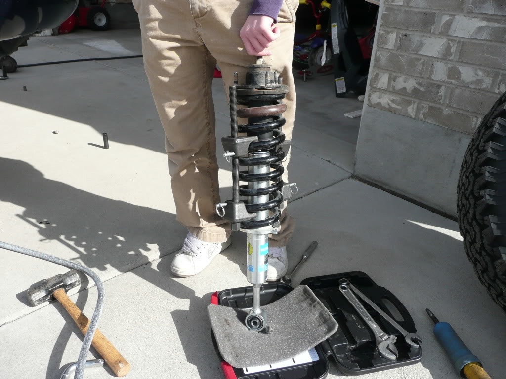

    1445123115674-303689105.jpg had a good workout turning that compressor but so far so good
