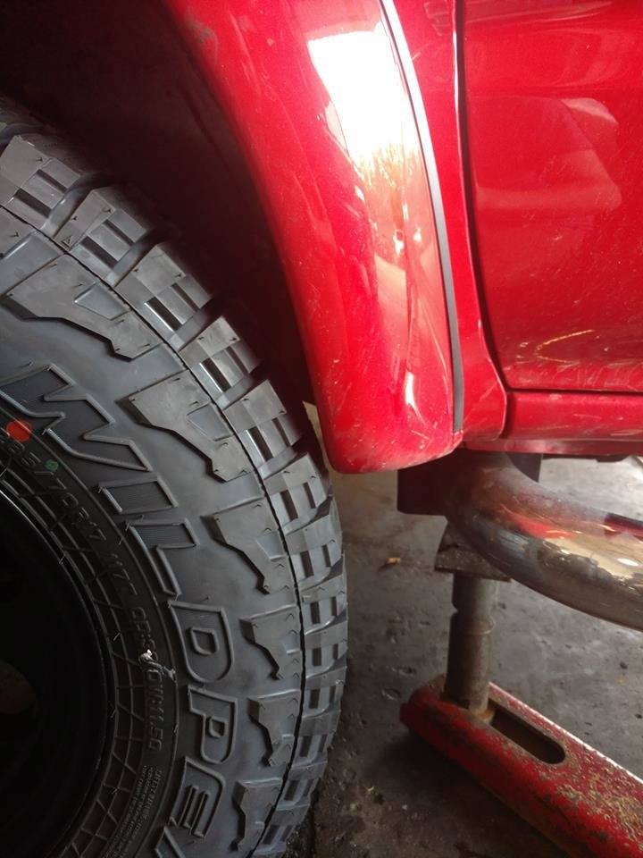

    @Fatal_Paradox, you generally shouldn't go more than 3" of lift without doing a bracket style lift (pre-runners can sometimes go more than 3, but not much - and only because there are no CVs to worry about). You get into a lot of alignment, steering, and CV angle issues with more than 3". A diff drop kit can help, but even then, diff drop kits only drop the diff an inch. Also, with 3" (even oftentimes 2.5") you end up needing new UCAs to help get proper alignment.I doubt you will get it aligned with 4".
    The other problem with spacers on top of a coilover is that you may end up bottoming out the shock before hitting the bumstops (=bad!), in which case you'd need to extend your lower bumpstops to prevent that. This reduces the amount of wheel travel since your droop travel stays the same, but you are limiting up travel. IFS has very little suspension travel to begin with, so I would try to avoid further limiting the IFS wheel travel...
    Most guys with 33's will have about 3" of lift, and end up doing some minor trimming, like the pinch weld and the plastic fender liner. Your problem might also be related to the backspacing of your wheels or the ridiculously huge 2" wheel spacers you have. Why do you have such huge wheel spacers?

    Okay I have had an alignment done before the wheels and tires were put on. @Sperrunner what do you mean to pull them forward? I also never wanted to add those strut spacers. I hated them that's why I took them off and replaced them with the rancho's. I also don't want to cut my fender flares. I don't care to cut the inner lining or the front bumper and to do the pinch weld mod. I had the wheel spacers to clear my UCA after I did my lift. I was rubbing. So I got wider wheels to eliminate that. But it didnt work out. I already have the wheels and tires. Its not an option to get new ones. I have to make this work.

    You need the caster around 4 or 5 on the alignment which pulls the wheel forward in the well.

    @JaCado After I did my lift and got it aligned. The shop said I would never get it truly aligned because of my pitman arm. Will they be able to do this with this issue?

    I was told by my brother in law (who claims to be a mechanic) that if you run a - offset wheel and/or spacer then it makes the tires and wheel swing out further during your turns thus causing it to hit and rub.

    @sportracer829 This is true, but I had to space out to clear the frame and my UCA after my 2.5 in lift. Even when I was on stock wheels and P265/75/16R
