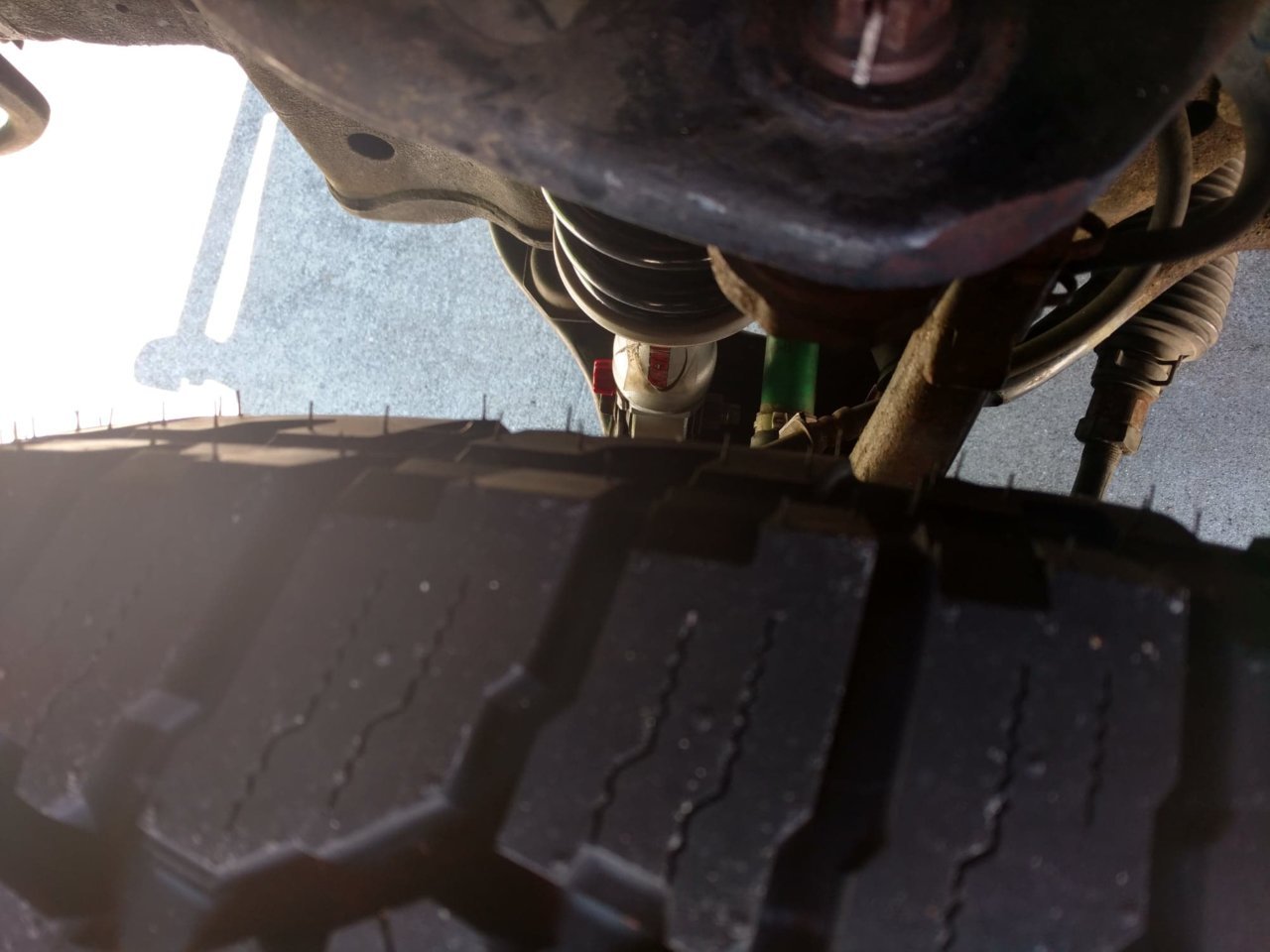

    Update on this. I was able to mount my wheels with no spacers and got rid of all my rubbing. The only downside is now I'm really close to my UCA. Is the only way to fix that to get aftermarket ones ?

    If your close to the UCA, like tire almost touching, the only way to fix it is more backspacing on your wheel. My tires sit less than 1/2" from my UCA due to running 3rd gen wheels but I dont worry about it. As long as its not rubbing I'd say your fine. Pics?

    that's like a canyon of space :eek:
    meh, you're fine. tire won't hit :)

    Its really only like 1/2". I haven't even checked yet if I'm hitting the frame :O I forgot to check !
