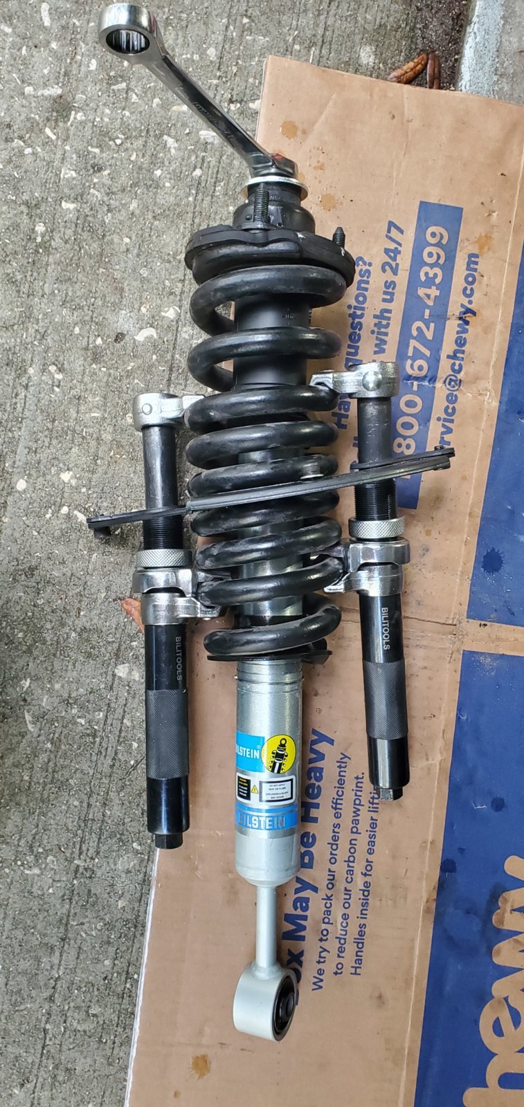

    TacoSupremo19
    TacoSupremo19 Well-Known Member
    Nov 24, 2019
    #311587
    1,290
    John
    NJ
    2019 Black Tacoma TRD SPort DCSB
    Brushed Copper Blaze 10 Rims | 265 70 17 Toyo Open Country A/T III tires | Bilstein 5100 w/ Eibach Coils 2.5" lift | Blackhawk UCAs | ICON Rear 3 AAL |TRD Skid Plate | TRD CAI | OEM Rear Bed Lighting | OEM rear Tailgate lock | RC Bed Molle Racks | Custom Blacked out OEM LED Headlights | MESO V4 Mirror Turnsignals | MESO Interior trim blackout | TG DMM dash mount | TRD Shift Knob | OEM SR5 interior door handles | Upgraded Stereo including Alpine 700W Amp Alpine Type R Components & Hertz speakers 12" Sub | Custom Clazzio Seat covers | Mobtown Sliders | Front Camera
    One critique of the video is it looks like he put the top rubber spring seat in upside down. That will mess with ride height a little.
    I've used this method numerous times. I feel much more comfortable doing it this way then those crappy ones you rent from auto parts stores (i have used those too). Those ones golfinda are using look pretty nice though. Still an arduous task going back and forth, HOPEFULLY with a power tool. If you are using hand tools, the level of suckage increases exponentially.
    One thing about the on the car method is when you put it back together, you need to be wary of the center bolt getting hung up and possibly damaging the threads.
    Lastly, one good thing about the on the car method is your new shing springs don't get all scratched up by the spring compressor.
