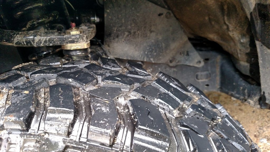

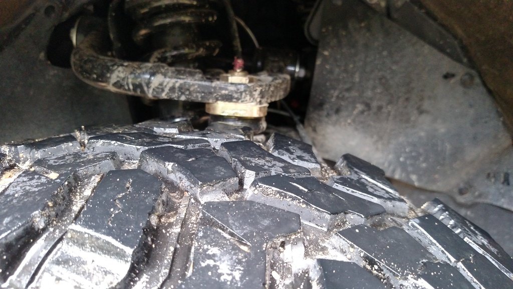

    Howdy,
    I have about 15,000 miles on my STT Pros and I am seeing some very uneven tread wear. Seems to be no pattern to it at all. Has anyone else experienced this? Also, how often do you guys rotate these tires?

    I rotate my ST/MAXX every 5,000 miles with an oil change. Your alignment could be off, mine have been on since October and rotated twice and all tires look to be wearing evenly

    Pics? Rotate front to back.

    No pics yet, Ill get some. I havent rotated at all...:oops:

    Way too many miles without rotating... Also how are your shocks?

    I will rotate...promise. BRand new OME shocks and alignment was good 0, 0, 2.4, but I guess it could be off.

    THere is no discernible pattern to the wear. After a lot of reading, and as a few of you have suggested, I need to rotate more often. For mud tires, it looks like every 3,000 to 5,000 miles.

    There's your problem bud. I rotate my ST Maxx every 5k. My buddy has the STT Pros in 265/75/16 on his 4 Runner and he rotates every 3k, he has 25 k miles on them and they are wearing perfectly.

    Yup...lesson learned. I will rotate every 3000 to 5000 from now on.
