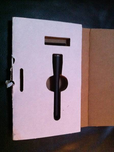

    It arrived in a nice package:

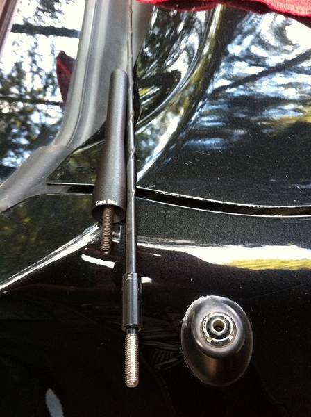

    Was easy to install.

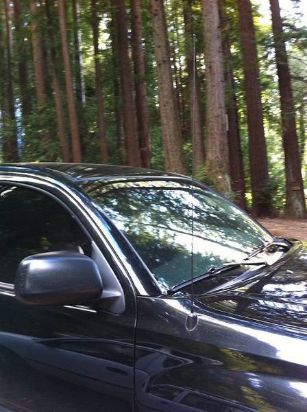

    Remove stock ordinary hum drum antenna.

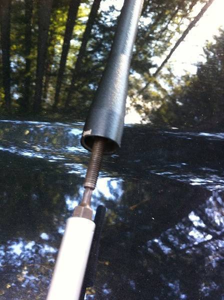

    The stubby comes with a torx screw. Just tighten it down into the stubby:

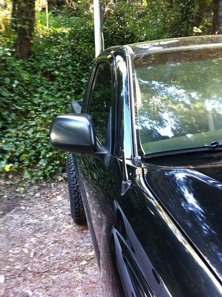

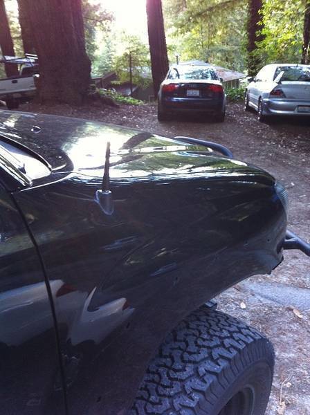

    Screw the stubby on and now you have a nice stylish pimpin stubby antenna but crappy FM reception:
    So yeah, the FM reception does degrade. I found though that if you adjust the stubby to where it is not in contact with the metal of the stock antenna mounting doughnut (for lack of a better term), the reception does improve. I'm going to mess with it a little bit and see if I can get the reception to improve. Maybe place a thin rubber spacer between the stubby and the stock mounting location.

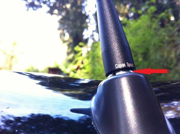

    I added a rubber gasket between the antenna and the metal surrounding the antenna port. The reception was improved about 80%! I'd estimate that the reception is about 5% below stock now. Just a slight crackle now compared to almost no reception before. Good enough for when I want to listen to the traffic report real quick.
    Before the gasket, the signal was being washed out onto the metal surface of the truck as apposed to being channeled into the center of the antenna cable.
    Also, without amplification, length really does matter. This is probably as good as it's going to get with this short stubby. That's what she said.

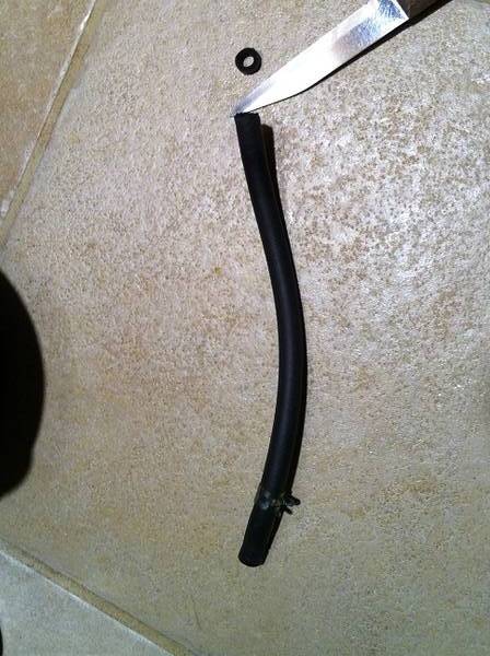

    I didn't have a rubber gasket, so I used the tip from an old hose I had laying around. That's what she said. I'm on a roll!
    1) old hose.
    2) Cut the end off, about a 1/8 of an inch.

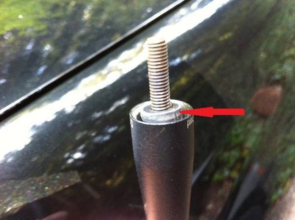

    3) Place gasket over bolt.
    4) Antenna no longer touches metal ground.
