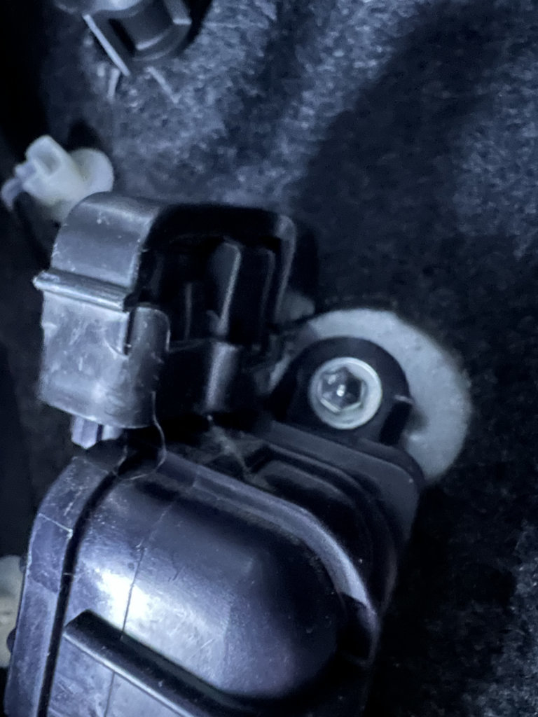

    I am having this same issue. Can't get the connector off of the pedal. Pressing every tab and pulling like crazy but it won't budge.
    B8232554-E8AE-4F08-9E77-07EA191944E0.jpg 125D5FDE-BCAC-4A0C-8CA4-CE36A9816C45.jpg

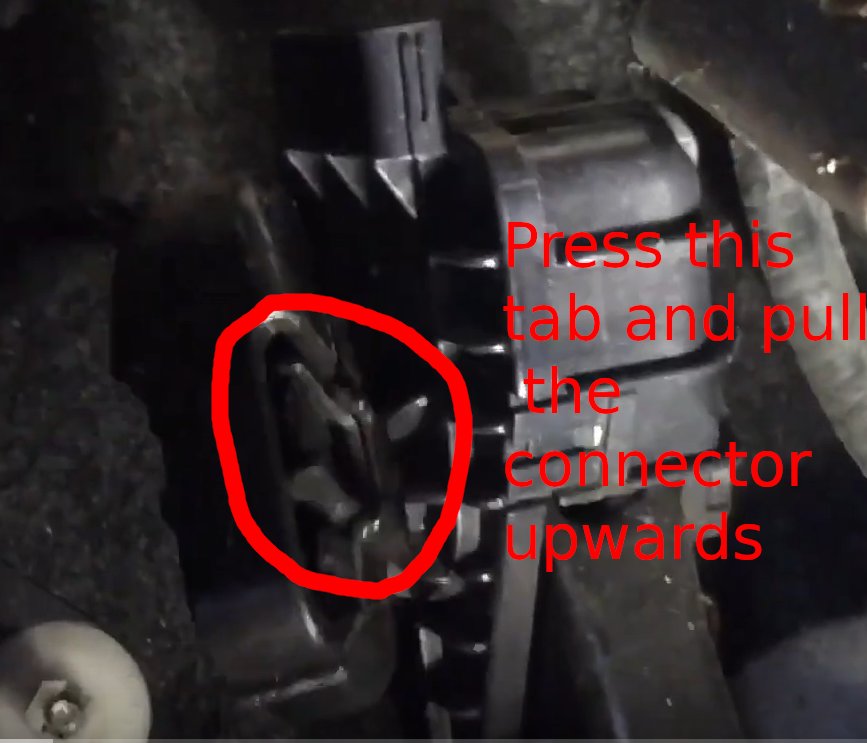

    This is what I found on the Interwebs:
    I can see this tab on your image you posted above.
    https://www.youtube.com/watch?v=kTEOwnq7HCE

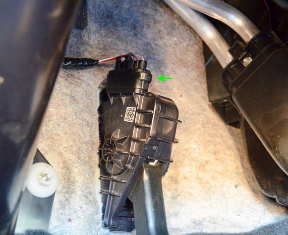

    I went out and looked at my 2012 and lo and behold it has a cover over it too.
    For grins I pressed the tab on the side towards the center console then pulled upwards while rocking the connector back and forth and it came right off...

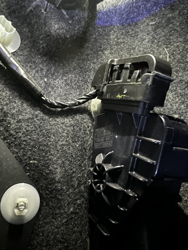

    Thank you Jimmyh for your help!! Unfortunately I still can't get this thing off. It's driving me absolutley crazy. I have no idea what I'm doing wrong because it should pop right off. My fingers are killing me.

    As in the image I posted it all comes off as one. Watch the video on You Tube I linked at the 2 minute and 18 second mark it shows the dude unplugging the connector and shroud assembly.
