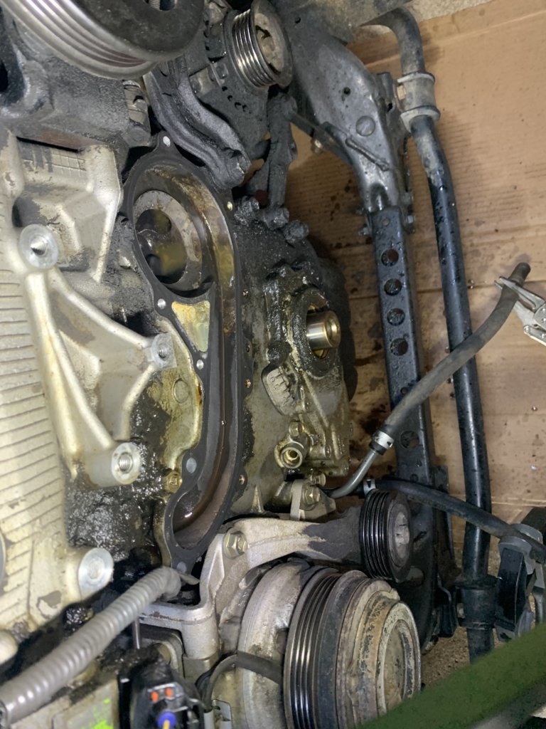

    Clock Volt meter/LSPV Delete/Hyundai 16’s/FP gauge/after 9months of wrenching ZERO oil leaks
    Man when I received my 96 2RZ
    Leaking like a stuck pig…from everywhere
    IMO
    If you’re RR’ng oil pump, might as well RR the $12 T cover gaskets too
    Big Job
    But you would be 70% there just RR’ng oil/water pumps
    happy to say after a slow and methodical 4days……ZERO oil leaks now
    That^^ is about half way
