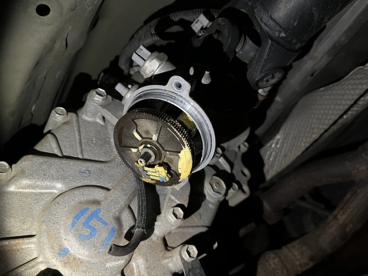

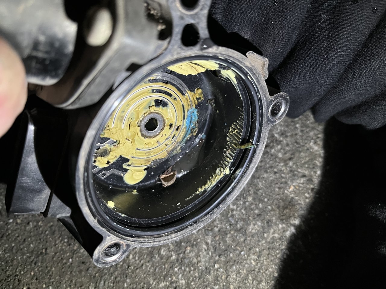

    @TnShooter @Dm93 didn’t feel like wait so I crawled under and popped the cover off. Water inside. Still worth testing the limit switch voltages at the ECU?

    Clean it up and see if it works, if it does replace the hose and you should be good to go, if it doesn't then test the voltages.
  11. Nov 23, 2021 at 9:07 PM
    TnShooter
    TnShooter The TacomaWorld Stray
    Sep 2, 2010
    #42625
    21,354
    Deogee
    07' TRD Off-Road, Auto
    STOCK
    Never seen that blue grease before?
    Sometime corrosion can turn a blue color?
    But do as @Dm93 said, clean it and try it out.

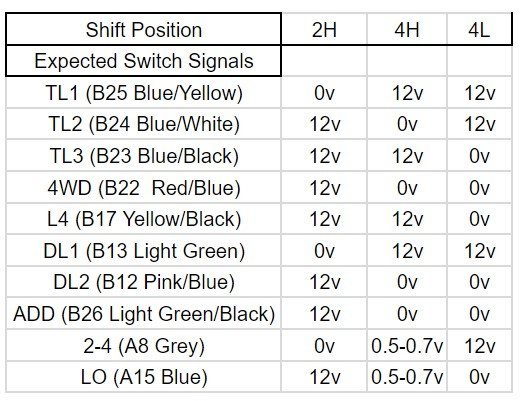

    Interesting the limit switches should be 0v or 12V, is this at the actuator or the ECU?
    With the actuator unplugged TL1, 2, and 3 should all be 12v unless a wire is shorted or the module is bad.
    TnShooter[QUOTED] likes this.
  18. Nov 24, 2021 at 9:17 PM
    #18
    TnShooter
    Sep 2, 2010
    #42625
    21,354
    Deogee
    STOCK
    Yeah, you can test them that way.
    But they won’t correlate with the values in the chart.
    If OP is even going by the Guide in the link above?
    This chart
