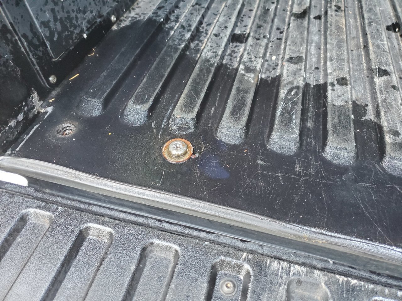

    Post a picture. Have no idea what bolt you are referencing. Some time you just break the bastard off, drill it out and retap.

    Here's the devils spawn.

    Are you talking about one of the bed bolts that hold the bed to the frame?
    If so, just be careful as those bolts fit in a “well”, so there is the bolt head, a washer, then about 2 inches of exposed bolt shaft in a “well” before the bolt passes through the bed and into the frame.
    One of my bolts was stuck and I broke it trying to remove it with a cheater bar. Royal PITA. The “well” holds water under the washer and the bolt shaft just sits in it rusting at that point.
    I don’t have much advice other than impact wrench and left hand drill bits to remove the broken bolt if it fails.

    Affirmative. Thats the one. I saw what your talking about underneath. Interesting design.:mad:

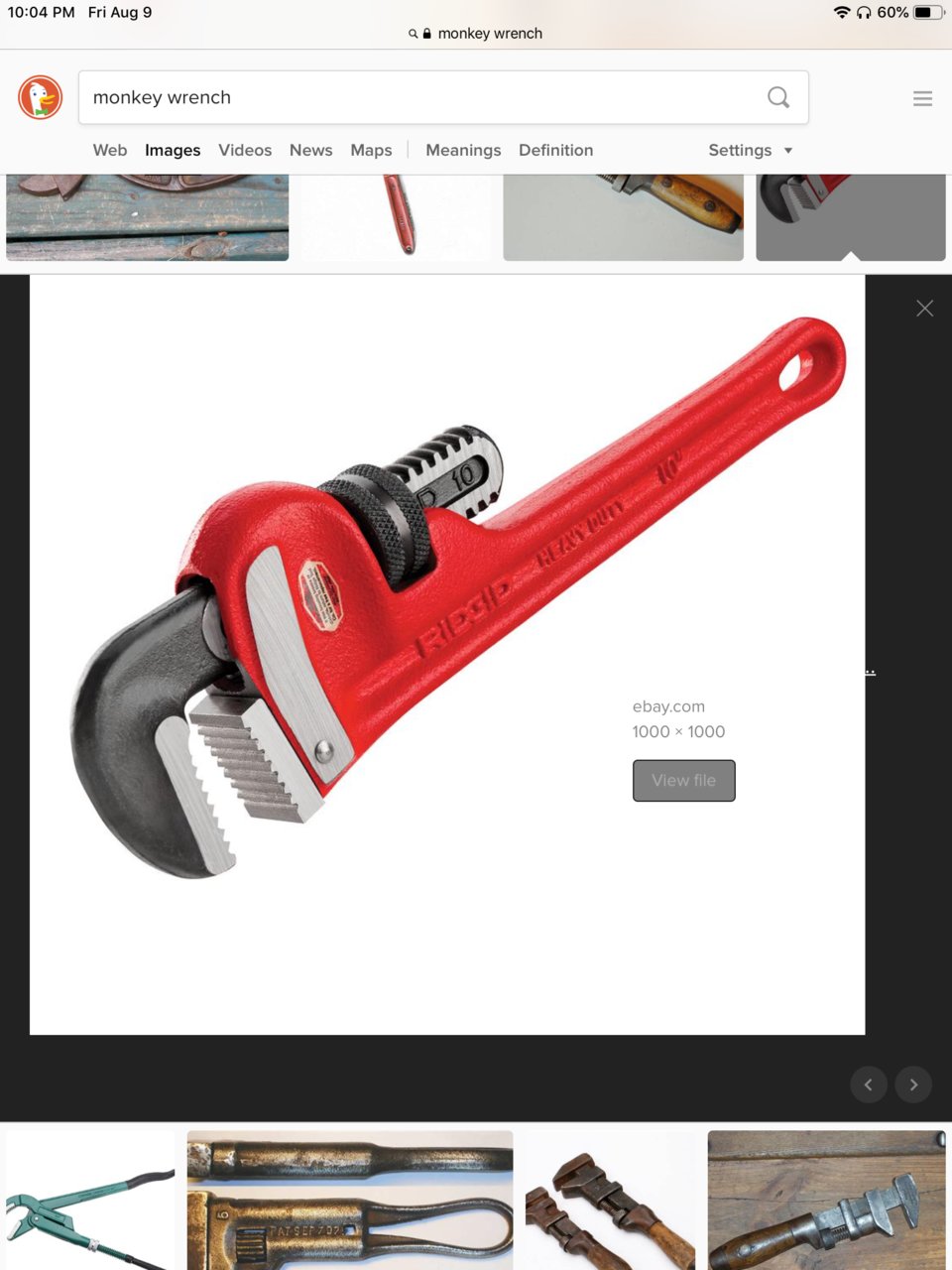

    Almost zero chance of this working.

    Wanna bet it will work or break off.
    wilcam47 likes this.

    ive used the "monkey wrench" on exhaust manifold bolts...i only ended up breaking on stud off, just because it was so corroded.
