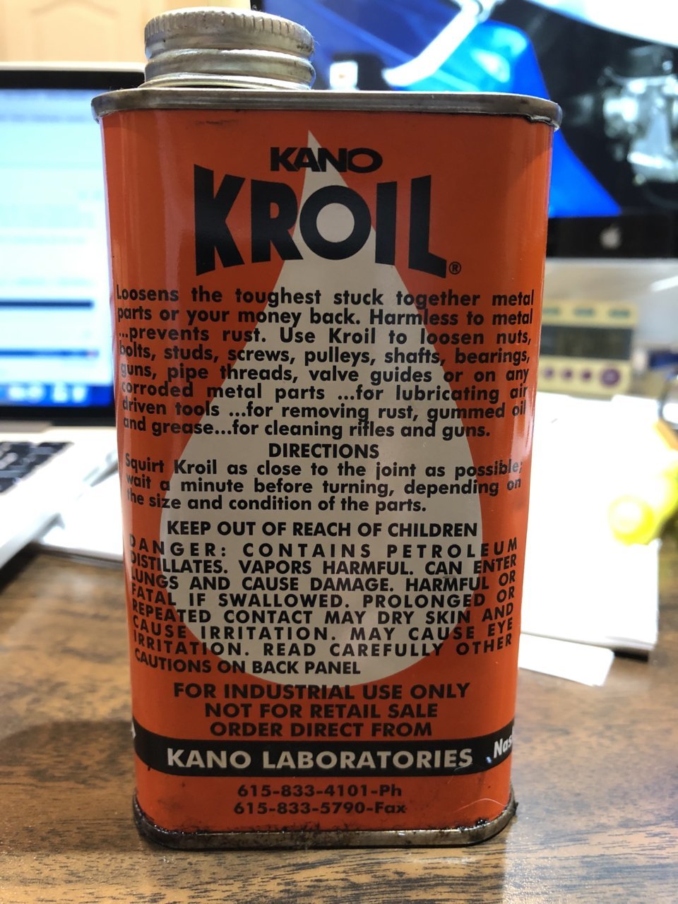

    Kroil is available through Amazon. I have used it for rusted or seized engine parts, after I saw a friend use it on a motorcycle restoration. He poured some onto each piston that had seized in place within the cylinder head. Let the oil covered pistons set for a week - and took a rubber mallet with a couple of hits, and the pistons freed up, and moved enough that he could disassemble the cylinder head.
    Kroil works best when you give it time to seep into the rusted or seized parts - not sure how much time it would take for the bed bolts in your truck.
