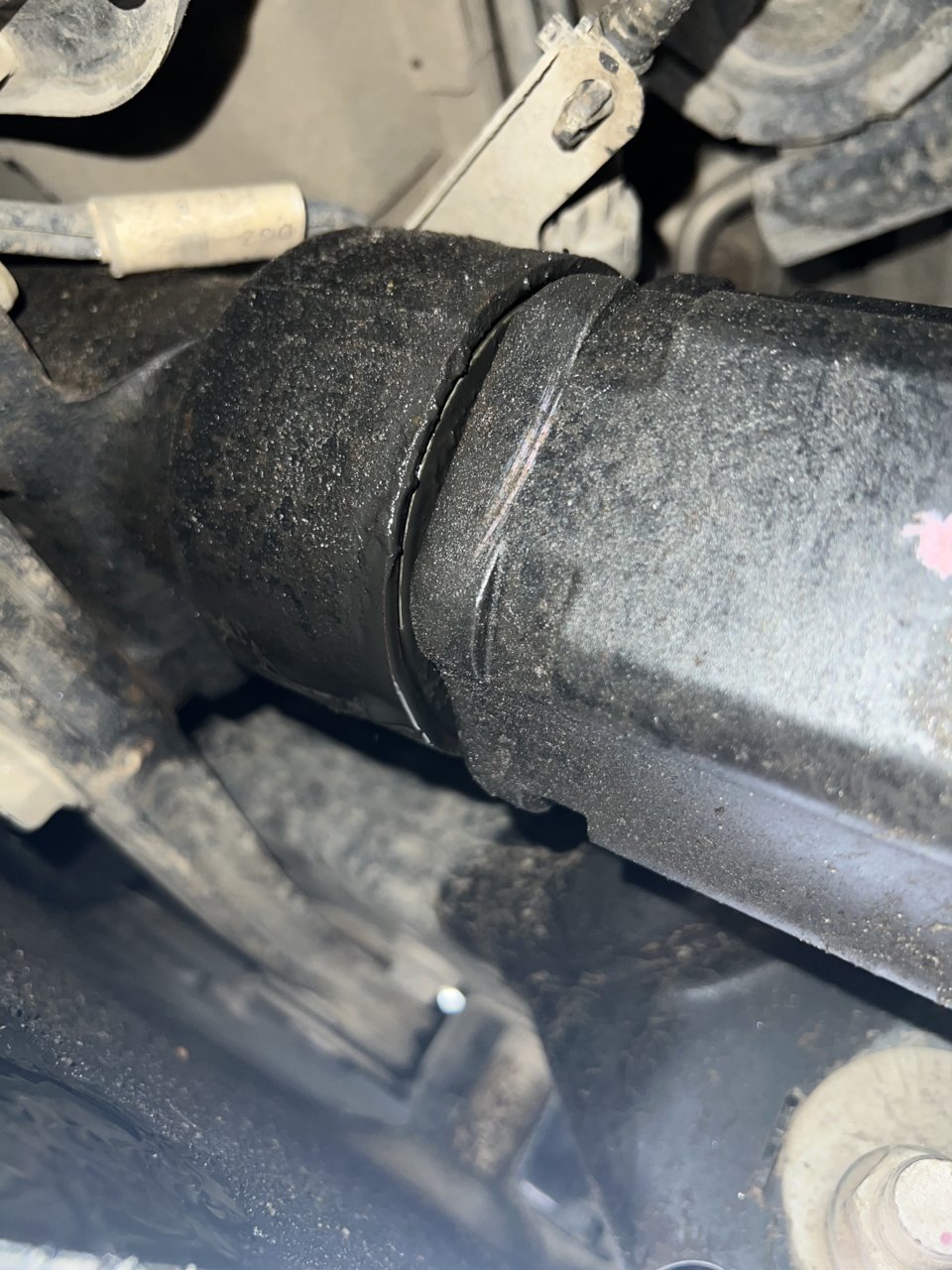

    I originally was replacing a $15 seal between my passenger side cv axle and the front diff because it was leaking. What looked like an easy task has become an absolute nightmare. I’ve used slide hammers, crowbars, cv axle pullers, pry bars, air hammers, and even a 20lb sledge hammer against the cv axle puller, nothing is working. Am I missing something? The wheel is fully removed from the LCA, the whole axle moves freely and it is halfway out, about a centimeter gap between the diff and axle. I’ve put hundreds of pounds of force against this thing for days and I’m ready to give up. Any highly unique/maybe there is a clip I’m missing comments would be greatly appreciated haha. Thanks!

    Can you post pictures of the the repair?

    There's a C clip on the inner end of the axle stub that must be compressed somewhat evenly or it will hang up, I don't see any tool marks and the CV removal flats where have you been prying/beating?
    Place a pry bar on those flats and give a solid tap away from the diff rotate the CV to the next flat is down firm tap rotate firm tap etc etc and it should work itself out.

    That was the picture before I started, half the paint is off this thing now. I’ve tried all of that.

    Red are the removal flats, blue is where the tip of the prybar should go green is the force direction, and again tap firmly but don't wail on it then rotate 1/3 and repeat.
