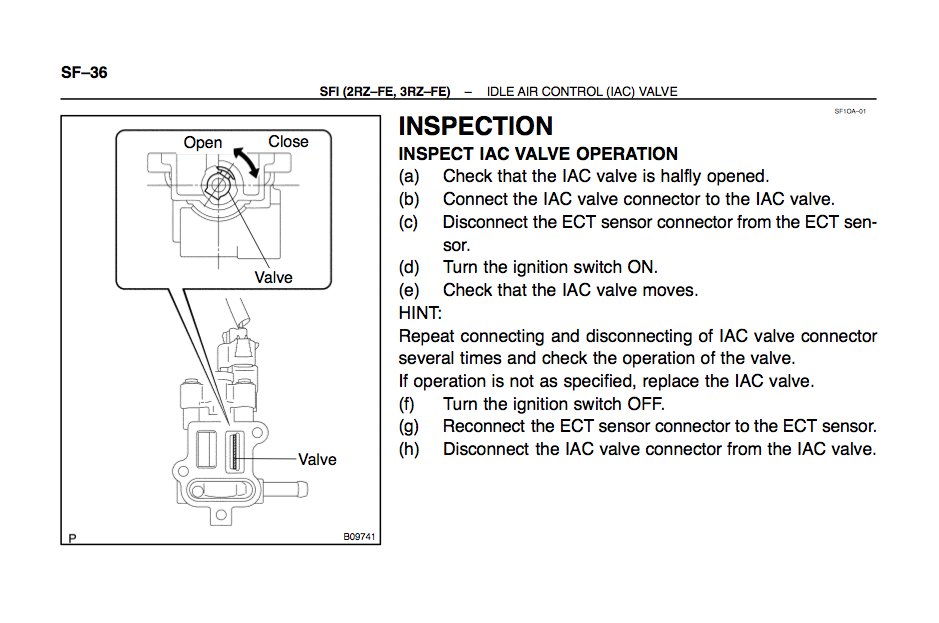

    I just found the IAC inspection in the FSM, which consists of about a million abbreviated folders and files. Going to go run the test and see how it fares

    So I tested the IAC according to the FSM (above), and it tested bad, the valve did not move. When I turned the ignition on I could feel power going to the motor, but the valve was not moving. So I went and got a new IAC and still the same thing when I went to test the new one. Not really sure what the problem would be, the procedure is super simple for testing and both IAC's were doing the same thing, not moving. Possibly not enough power to the IAC?
    So heres question number 1. Would a bad IAC cause the idle to stick high? Today it started cold around 1400-1500 RPM and increased to about 1900 once the engine was at temperature.
    I also tried while the engine was running disconnecting the vacuum line from the throttle opening diaphragm. Not much of a change there, but while the engine is running there is about 5mm of clearance between the stop screw and the rod coming from the diaphragm. There is zero clearance when the engine is off. Id imagine that fine because vacuum is going to pull that rod away from the stop screw.
    Im gonna go mess around with this thing some more and try and figure it out. Any ideas or feedback are greatly appreciated

    Yes, an IAC can "stick" in any position. Not likely 2 in a row. Try the tests again.
    and
    The "throttle opener" should hold the throttle plate open a tad when the engine is off. With vacuum (engine on), it should pull the throttle against the stop.
    All this can be found in your (online) 03 FSM under...... repair > sf2rzfe3 > thrbod.
    The throttle opener is a stand alone "system". It holds the throttle open a bit via a light spring when the engine is off to allow a little extra intake air while starting. As soon as full manifold vacuum is developed the diaphragm overcomes the spring and allows the throttle to close fully. It is only purpose in life is more efficient starting. If the TO is bad/leaks or there is a vacuum leak in the line it could allow the throttle plate to stay slightly open. The resultant extra air would be more than the ECM controled IAC could compensate for.

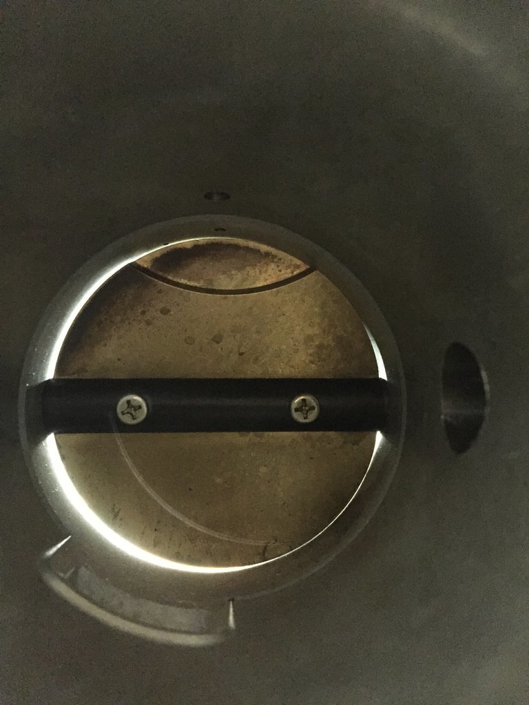

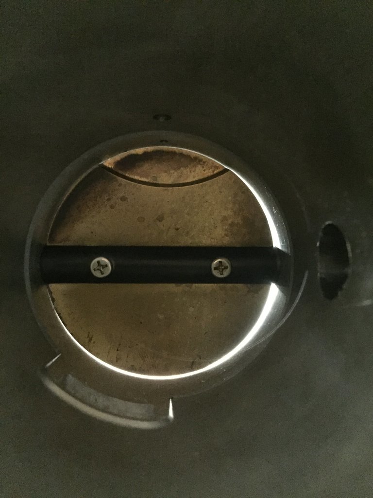

    Upon further inspection I discovered a little bit of play in the throttle valve, seems it must be worn. Looking on forums ive seen a lot of these high idle problems sprout up after cleaning the throttle bodies. I wonder if cleaning them gets that little bit of gunk off that helped make a better seal on a worn throttle body.
    Heres my question: Is there anywhere that makes a throttle body rebuild kit for these things? I cant seem to find one.
    My next bet may be to replace the throttle valve, which seems to be the worn piece. i just need to find a parts catalog with a part number for the actual valve piece, which would be an easy replacement. Anybody have any experience with a work throttle body?

    Don't know of any rebuild kits myself. Maybe a used throttle body.

    Are you sure you were unhooking the correct ECT sensor?

    Is there more than one ECT? I unhooked the Engine Coolant Temp Sensor thats behind the block. If I understand correctly it just makes the engine think its running hot when the ECT is unplugged, which should open the IAC.

    Still no luck with anything ive tried today. The idle has calmed down to about 1,250 from just under 2,000. Its still kind of erratic though. For instance if I coming up to a stop light and I shift into Neutral the RPMs go down to about 1,100 and then surge a couple times before settling back down.
    I gonna give it a couple days and see if it settles in, I double checked all the vacuum lines today and blew them all out. Didnt find anything there.
    My guess, if nothing changes is the little bit of play in the throttle valve is letting enough air in to make it idle 500 or so RPM high and the IAC is doing its job correctly. Here are a couple pictures of the throttle valve, its got some play horizontally, so you can see the change in light getting through when you move it left to right. IMG_7117.jpg IMG_7118.jpg

    That's a huge gap. You can't get it to close any tighter?
