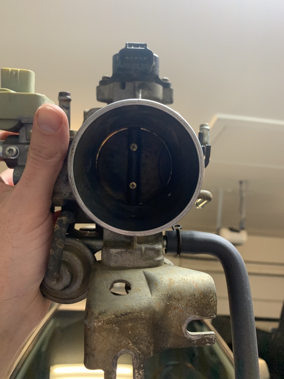

    C1527ED5-F829-4680-8BB2-DC2C36D05DF5.jpg Give us an update!!
    I’m going nuts with a Similar situation.
    Had a burnt exhuast valve. Got the entire head replaced by a shop and they cleaned the TB. They told me the IAC Valave was super dirty and tried to clean it the best they could. I was suppose to have normal idle in about a tank or two of gas (never happened). My truck idles about 1,250 and will bounce down to 1,000 multiple times.
    Now I replaced the IAC with a new OEM one and it’s worse. It would idle way above my old OEM one and bounce down to 1k then back to 1,250-1,600. Then steady at 1,800. So I threw my old OEM one back on...
    I noticed I have a slight gap on my TB butterfly plate. Not sure if this would be the issue...
    Any guidance would be greatly appreciated

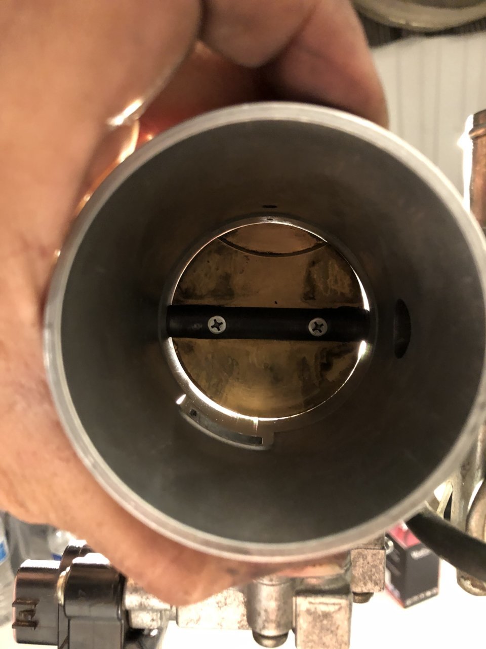

    Here is a shot of the throttle body plate.
    im going to do a compression test next weekend if I find time to mark that off the list.

    So there is a stopper screw that can set the throttle plate minimum position, right? My plate is going perpindicular so I don’t think that is the issue...
