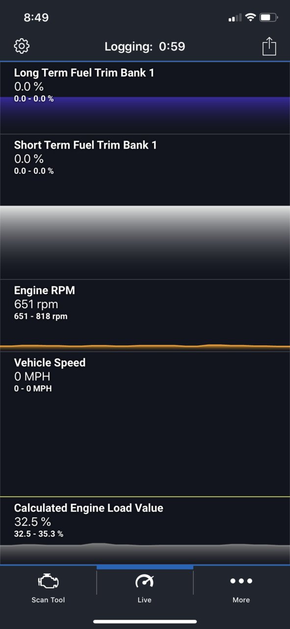

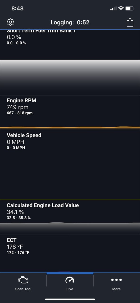

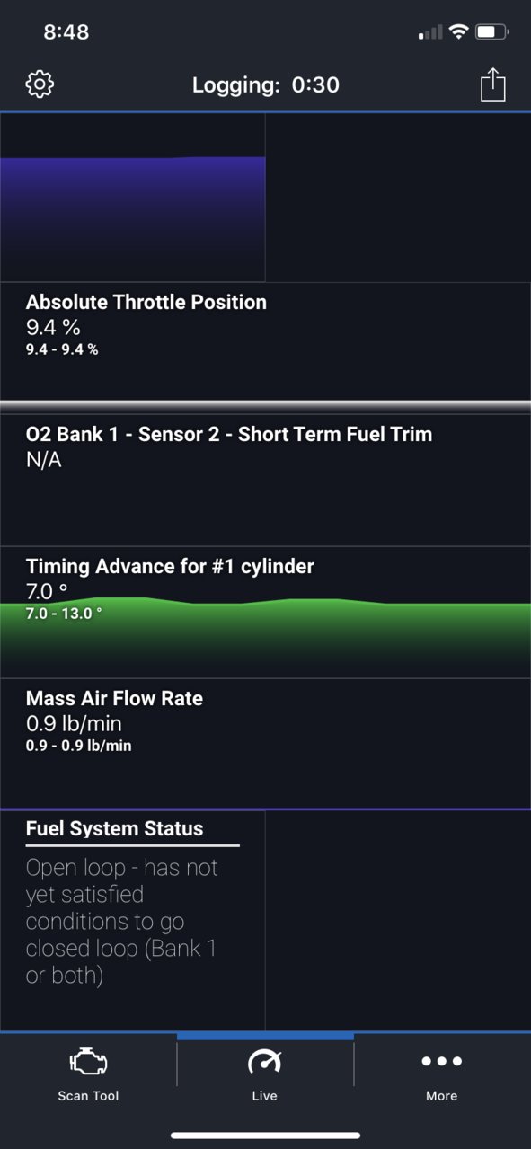

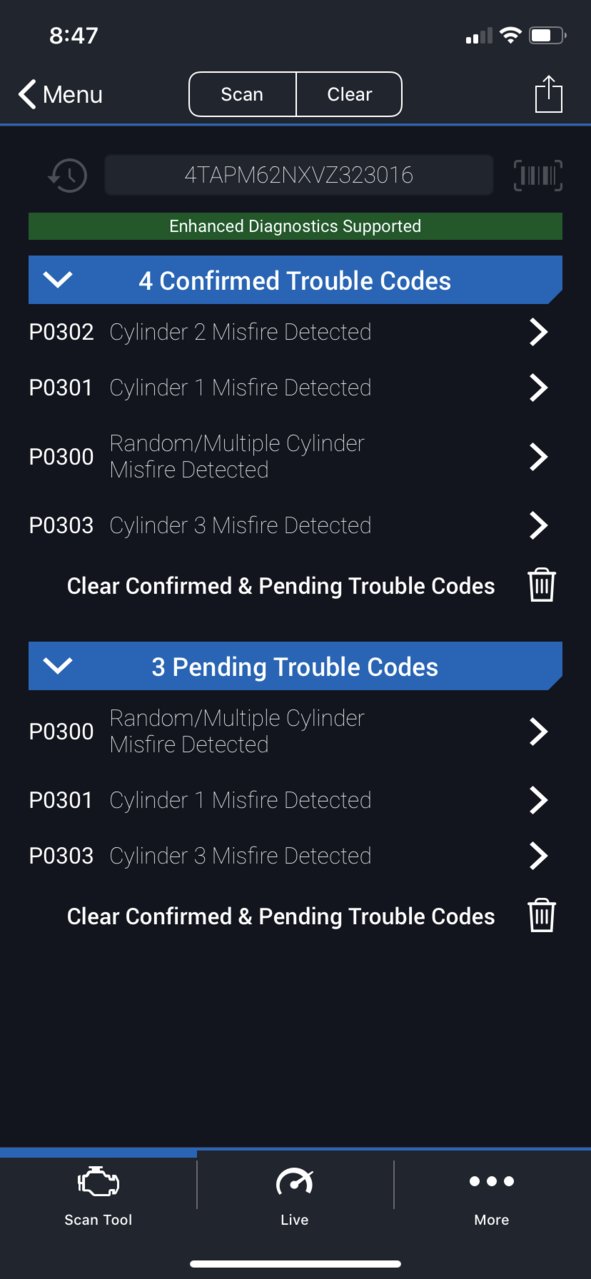

    I read you report. Remind me what all you have checked. I’m having rough starts that I think are due to a flimsy iac hose replacement . I’m going to put a factory one on in the morning and see if that was it. Truck has always started strong so I’m perplexed. It even started strong with the major vacuum leak.

    My idle is about 1,000 rpm in park and about 750 in drive. See attached video does anybody else’s vapor canister making this whooshing noise.
