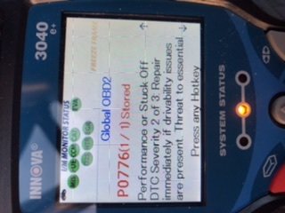

    I’m getting a PO776 code
    Truck has about 107,000 miles no work done transmission as far as I know.
    Check Engine light came on today

    Hey Gearcruncher,
    Had all that work done yesterday and seems to have solved the problem. You don’t know how much I appreciate your advice. Thank you so much‼️
