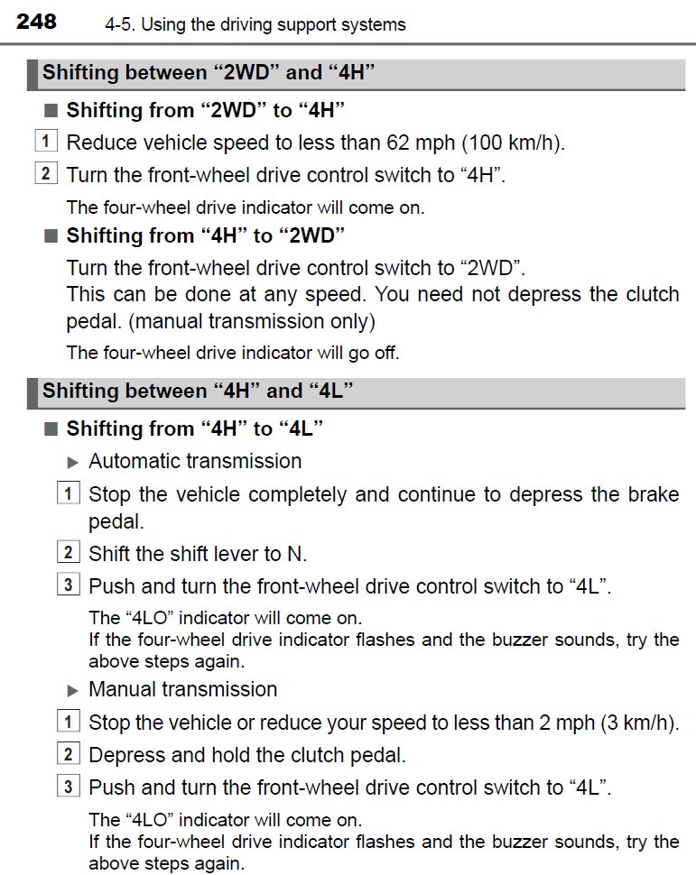

    Another similar mechanism in the tcase goes from 2Hi <> 4Hi <> 4Lo.
    Also I'm a bit confused why everyone is saying keep your foot on the brake or apply parking brake etc. In all my experience it helps a lot to be rolling (slowly) when making the Hi / Lo switch.
    I'm curious what exactly happened when your wife did the initial switch? Flipped it to 4Lo and instantly flipped it back to 4Hi? Was it in gear? Trying to figure out exactly how we got here

    For 4Hi, the T case actuator presses against the synchro to spin up the front drive shaft and engage high range dog. ADD connects the axle shaft.
    For 4Lo, the T case actuator just throws further to move the dog from the 1:1 high range gear set to the 2.57:1 low range gear set. There is no synchro, so it has to be done at a stop.

    The truck was parked in our driveway in 4hi . It’s steep and snowy so the truck is usually in 4wd.
    She said she flipped the switch to 4lo by mistake in park and then shifted into drive. When she got back she said the truck was stuck in 4lo.

    I think you can get to 4Lo from Park. I haven't played there to know. The couple times that I saw ATs going to 4Lo was in Neutral.

    Have you tried to fully disengage 4wd and put it into 2wd? If it is in 4Lo, make sure the switch is also in 4Lo before starting the truck. Start the truck and shift to neutral, now turn the switch to 4Hi. Wait for a minute and if needed let off the brake and let the truck roll slowly come back to a complete stop and see if anything changes. Regardless of what happens I would now shift into 2wd and see if 4wd disengages.
