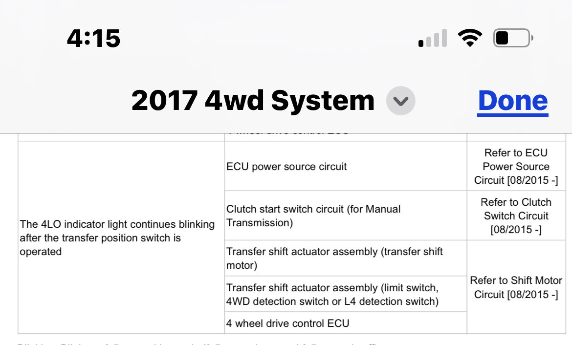

    Wow that just went over my head pretty quick. I read through those and this is what is happening.

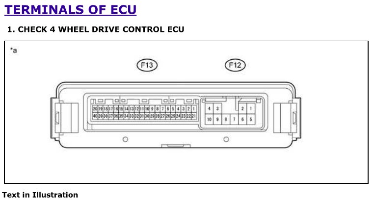

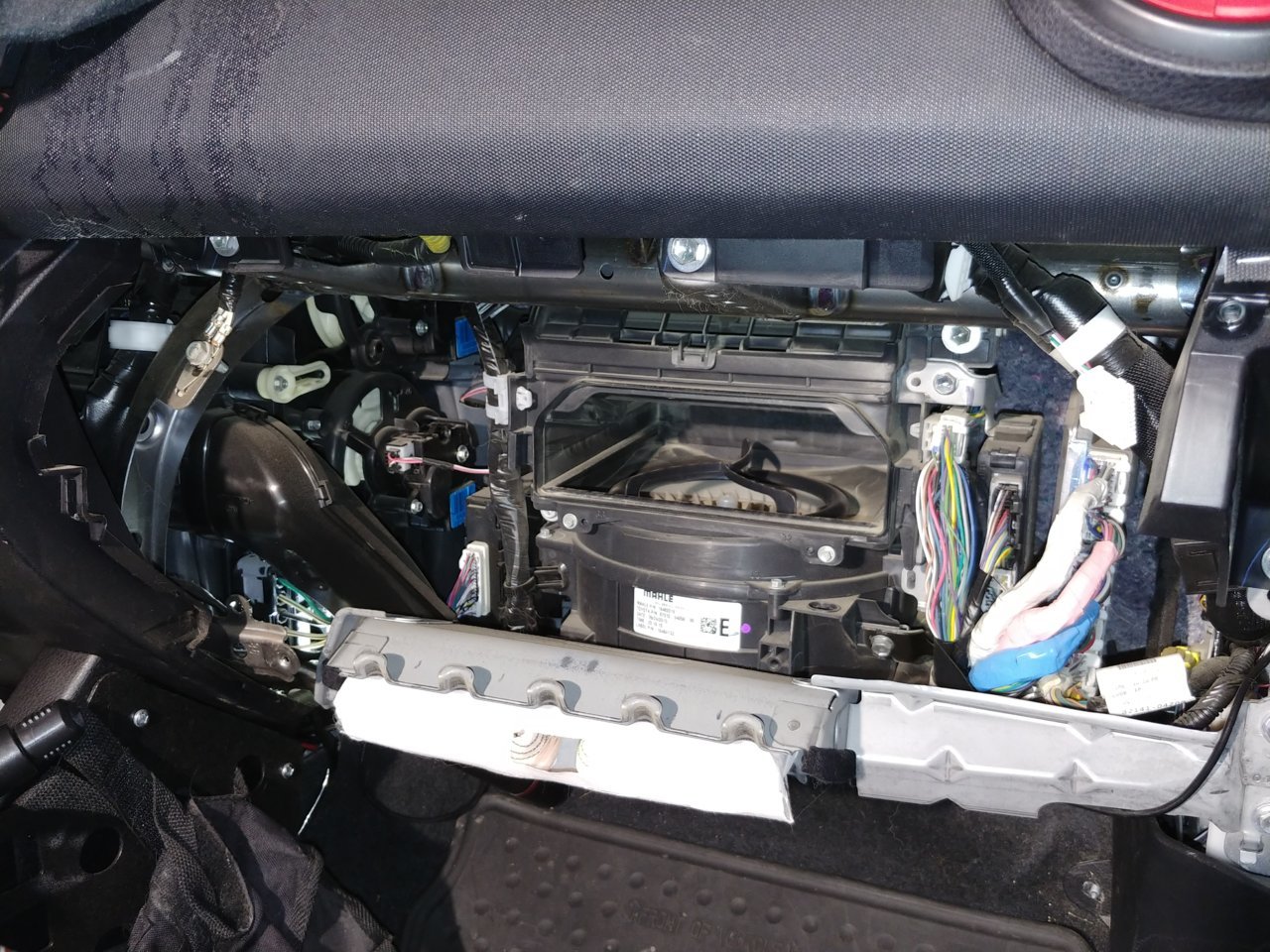

    4WD ECU should have two connectors on it. F13 is the large 40 pin, and F12 is the smaller 10 pin. This is a view looking at the ECU. Real world pic below, 4WD ECU is the black module in the middle. Careful of the airbag in front of the blower..
    I recall having a hard time getting back there. If memory serves the 3rd gen glove box / surrounding trim removal would rival BMW stupidity. Might get lucky and just pull the glove box itself? But anyway

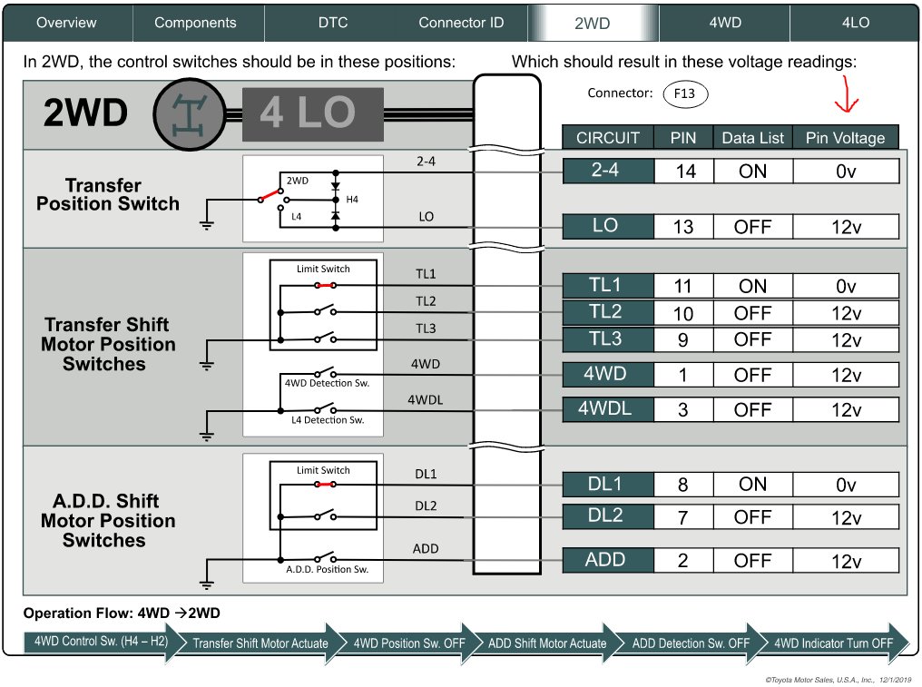

    Attached PDF is a guide to the 3rd gen t-case. First few pages give an overview. Pg 5 shows the Neg lead of your DMM will be on a solid chassis ground point, and the Pos lead will be used to carefully backprobe the indicated F13 pins. If you take a reading and jot down the voltage at each pin on Pg 6 we should know where everything is.

    Looks pretty good so far, I did one on the 2nd gen system which looks to operate about the same but I went with voltage checks instead of resistance as that's what the ECU sees and is more reliable.
    I don't have a 3rd gen to study so I couldn't say what voltage its using but most sense circuits are either 5v or 12v, when the limit switches are closed you would see 0v.
    The nice thing about the 3rd gen system is it's ability to communicate with a scan tool, that makes troubleshooting 10 times easier as you can see exactly what the ECU is seeing without the need to backprobe wires to check voltages.

    fyi, i don't think have to take off the entire glove box to access the ECU. you can just take the cover off the cabin air filter access hole. I have to take my filter out and remove the leaves once a week since it's parked under a tree and I can see the wiring going to the ECU.
